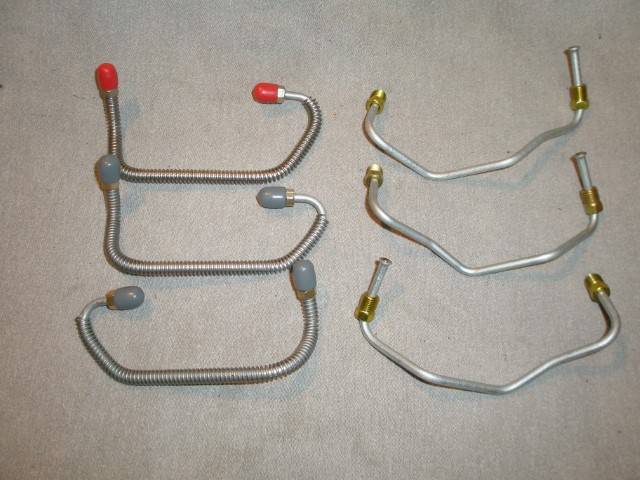

Is this typical out of the package fitment for this line?
I know I could bend it into position, but didn't expect engineered from factory lines and cnc bent to be this far off.
The one installed with gray cap is inline tubes.
The one zip tied on top is fine lines.
Lines were ordered for 72 Dart with Kelsey hayes disc brakes.
Thanks, I now see inline tubes list a set for 71-72 Dart with disc SDDB6709 which I bought.
They also list a set for 67-70 Dart with disc SDDB6704
I thought all A body 65-72 were KH 4 piston caliper.
YES, All 65-72 "A" Body cars are Kelsey Hayes disc brakes.
Brake lines, for all the years are the same.
Your are aware lines are bent, for left and right side calipers.
Possibly the catalog listing is "F" ed up.
My spare lines are both from Inline Tube, and Fine Lines.
No difference from either vendor.

I was hoping you would come along and straighten me out :thumbsup:
Yes, I am aware lines are for left and right.
Fine lines even had the crossover lines labeled wrong, right label on left/ left label on right.
I know your correct, catalog listing is wrong with inline tube.
I will just bend fine lines tube into shape when I install.
