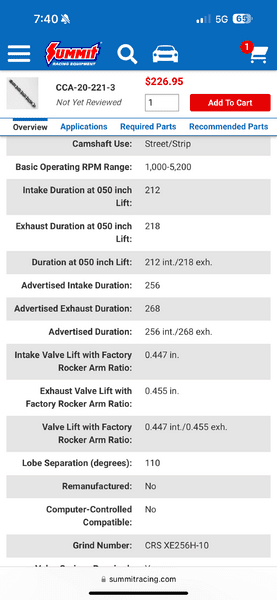

this one?
the only thing i like about that cam is the 110 LSA. more lift and basically the same duration as a 340 cam? pass.
not a great match for low compression, street master and a small carb.
Bigger than I was looking at. Hang on a bit.
I just took a screenshot of it.
better, than the first one. it's similar to an old MP grind (a little less duration on the intake) which is cool. it can make some power with the right supporting cast.
You feel 110 LSA for a low compression engine would work, or lose the bottom end?
yes! a tight LSA is going to promote bottom end torque and midrange with a sacrifice to idle vacuum, which can possibly result in fickle street manners-- this is generally in more radical instances like, say below 108.
but i wouldn't hesitate to run a 110. and on a small cube motor with low compression i'd much prefer it over the typical 112~114's that are generally offered.
