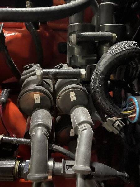

Any chance you have a better picture of your coil pack brackets? They are laid out very nicely!

I don’t have any of when I was making them. I just took this one last night for you. The lower portion is a flat bar that back 2 intake bolts go through. Then a perpendicular flat bar welded to that with some tubing perpendicular to that. The tubing goes through the flat bar. I set it all up to get spacing correct, then tacked the tubing in place. It took a lot of time and it is really tight back there.

I missed that you packed LS coils in there. I guess I didn't look close and assumed they were the two ended block coils like the Viper runs.

Thank you! It really is tight back there, and the coils are a bit bigger than I had realized. I’m going to attempt similar positioning, but am curious to see how my distributor sensor will impact space in the area.

mug you’re using a distributor base as a cam sensor, they won’t fit in this arrangement. It’s really tight and it took a while for me to make it work. I made this bracket with the engine on a stand and it was a pain. It would be much worse if it’s in the car
