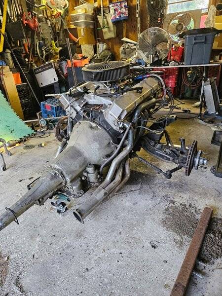

I like to put all that stuff on like JYH did but install the engine on the K including headers and then slider her in using the engine hoist in front after blocking the rear tires up….if you do not have lift.
Take your time. Don’t tighten up until weight off car is on it all.
No point in tightening until engine is in.
No point in installing K (in my opinion) without the engine.

Make a jig to hold it all on wheels.
