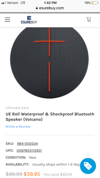

I have one of these my son used it in his convertible he would hang it from the mirror I still use it working outside or BBQing charge it with USB in cigarette lighter great sound and loud get 2 and pair them
I lost one outside for a year in the leaves charged it and still use it today. Much better that those cylinder shaped ones. Although with the cylinder ones some you can turn on with an app. This one will not. This one is about 4 1/2 in diameter
