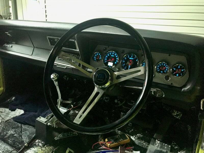

I built a custom dash for my Hardtop using their gauges, the oil gauge has a programmable warning light built in to it.
