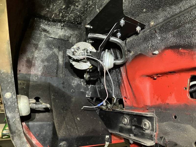

I have a '70 Charger with a fairly big cam in a 495 cubic inch big block.
I tried running a manual master cylinder with the 4 wheel disc setup and the pedal effort was way too high.
I was simply trying to emulate the feel and performance of a basic A body front disc, rear drum arrangement. I have built several Darts and Dusters with 11" front discs from a 73-76 A body, 10" rear drums and a non power assisted 15/16" master cylinder. Those setups are fantastic. My 4 wheel disc setup is finally optimized but to get there in this heavier car, I had to use a vacuum pump and an inline storage tank.
