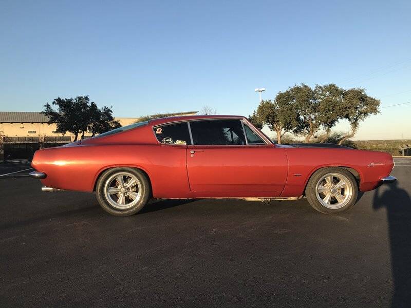

I have Firm Feel with -1 drop. Wheels ar 17x8 in rear. I think they are 275/40.
