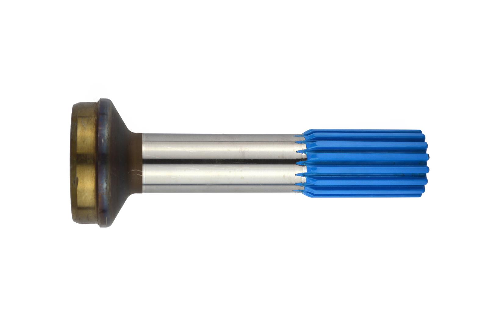

after diving deep into spicer#s the slip yoke # does not come up anywhere...2-3-800kx......there is a 8001kx..........
Then all you need is a 2.5" drive shaft tube.

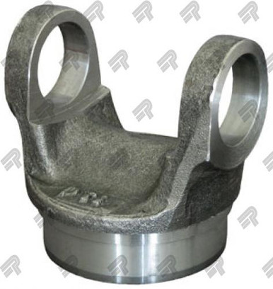

It's 2.5" a weld on u-joint yoke for a 1310 or "whatever" u-joint you're using on the rear of the drive shaft. If you can't find THAT, then I suggest stamp collecting. LOL
naah..not stamps...coins..sii......its a combo u joint to oe diff yoke....
I'd get rid of that problem. Just get the matching weld on drive shaft yoke for whatever rear end yoke you have.
was told by dennys out of ny...and a gent in dfw.....no one makes the small weld on mopar yoke anymore for the 2.5 tube that fits the oe joint.......so combo joint is the only way...witch is fine ill never whear it out anyway...
So that's a 7260 joint? Is that right?
If yours is the 7260 joint, here's the weld on yoke.
