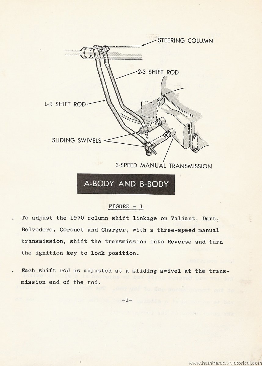

  3. customsportsman
    customsportsman Member
    Messages:
    12
    Likes Received:
    12
    Joined:
    Apr 15, 2019
    Location:
    New Baltimore MI
    Local Time:
    5:12 PM
    Sorry...
    1970 Dart, slant six three on the tree car. A 903 transmission. I did do that procedure that you show. I am looking for some way to tighten up the steering column part of the shift linkage. Mainly the shift gate.
