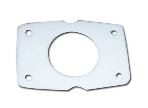

I made an 1/8" alumium spacer on my Master cylinder but non-power disk.
