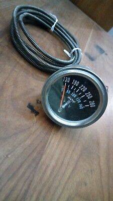

What mechanical gauge works with this
Electric temp and pressure gauges are almost always 90° sweep, mechanical temp gauges use an unremovable Bourdon tube, and are usually 270° sweep.
What does that mean
He's talking about the needle sweep. Some mechanical gauges have a 270 degree sweep face like this
mages?q=tbn:ANd9GcQXyxaMPtl2Gu3TBZyYU0TG_N-e6aNZOLAH2pGuD7c92cnegrE5nSszW9Zk3lBi7qFwpZQ&usqp=CAU.jpg
But this is not always true, either
