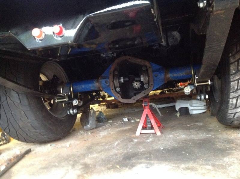

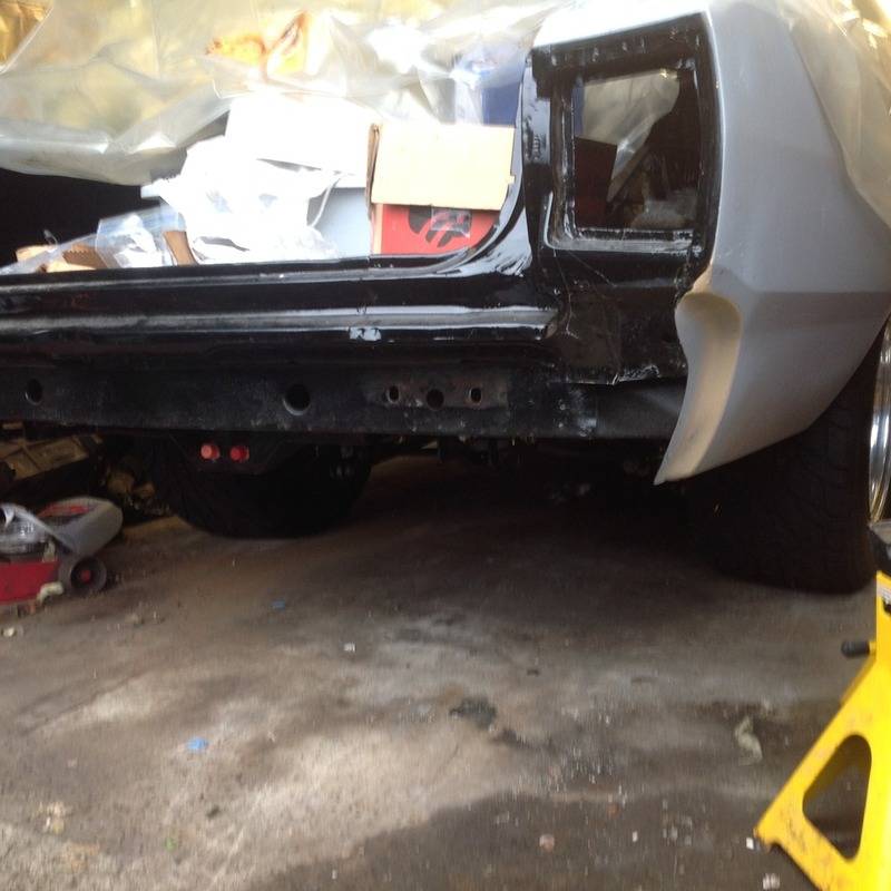

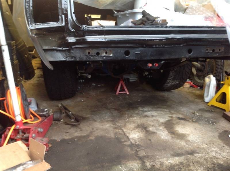

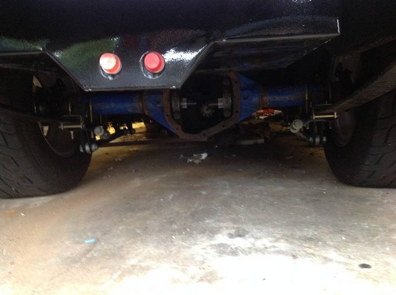

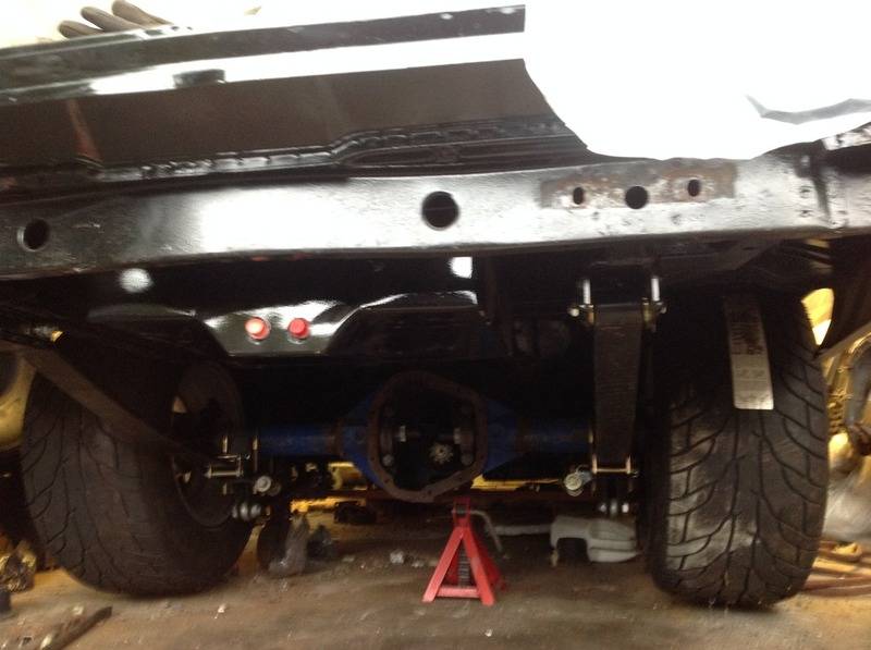

Well time sure does fly, finally got the bug back and started back at it. Mocking up the Dana for proper pinion angle so started bolting stuff together.

Need get the tires where I want them in the wells and check the offset for the drive shaft, then load the suspension.
