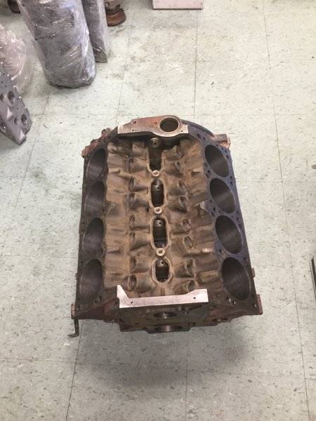

    Starting a mild 360 magnum build, goal is a strong stock stroke daily driver.
    Block is out of the hot tank and the bore was good ...but it will end up going 30 over due to local parts suppliers not having any stock bore pistons... I will Dyno and post results

      somebody might have stock pistons here on FABO???

      RockAuto shows Enginetech std bore pistons in stock. Bet there are others that have them.
      If overboring, why not put in something better?

        If the bores are good, straight and round with no noticeable ridge, why bother paying to bore .030" over and having thinner cylinder walls? Use the cost of boring to pay to get a set of standard bore hyperutectic pistons shipped accross the border.
        Not being negative, just wondering.

            I went .030 over due to parts availability also. Machine shop said .010 would probably clean up my magnum block. .020 would get it right for sure. My dad had a set of new .030 KB pistons for free so thats what I had done.
            What heads and cam are you using?

              The pistons are silvolites and they had them local along with the rest of the bottom end parts... so I grabbed them. I don’t think the fresh bore will hurt.... plus it keeps the local machine shop opened

                EQ heads and a lunati cam the J.Rob recommended based on some info I gave him

                      Sounds like a good plan. I like the Magnum 360 for street builds, so I am looking forward to the dyno results.

                                        Are these silvolites stock compression height or "destroked" rebuilder pistons?
                                        if destroked you mostly lost your quench
                                        did you measure deck clearance on the stock pistons before you pulled it down? what was it?
                                        and BTW what's wrong with re-ringing the stock pistons?
                                        I'm thinking you will need a thin headgasket and even so may not get down to the .030-040 ideal quench distance
                                        so you may end up needing to deck the block- and if you measured all four corners you know if it's square already LA can be all over the place- IDK about Magnum i hear they are better
                                        I used +.020 KBs in one of my last 360 builds but I think that was an LA block not magnum
