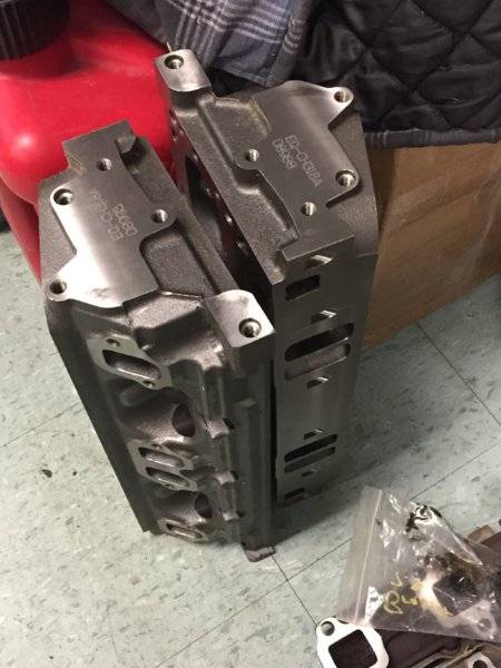

Heads showed up... one on Friday and one today Monday...we had a look and are going to order 2.02 and 1.6 stainless valves

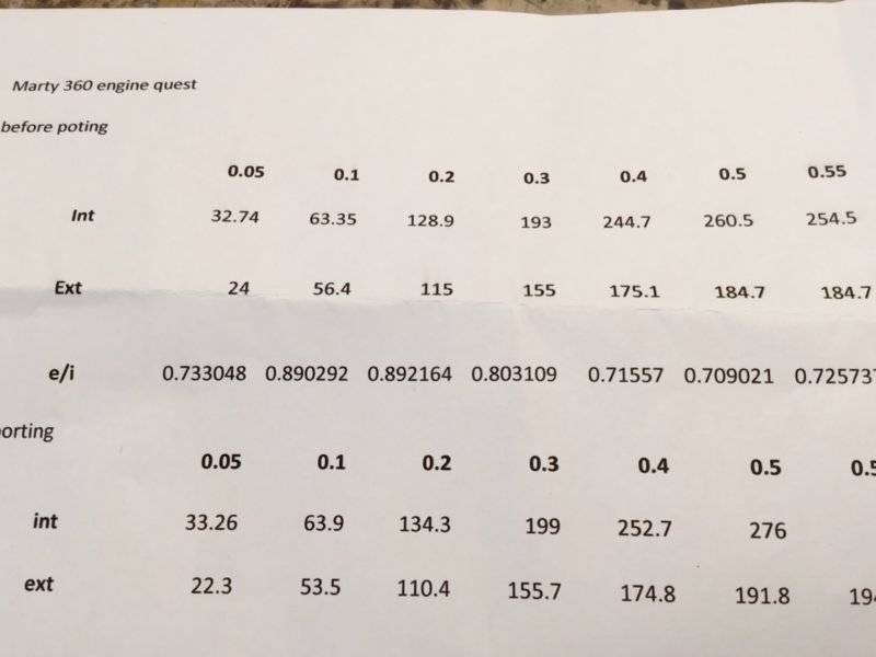

Heads are cut now for 2.02 and 1.6 valves...in the next few weeks I will do a bit if grinding and see if I can get some flow numbers.

The valves seats are cut for 202/160 LS valves, on March 16 I'm going to pocket port the heads and flow them for ***** and giggles. I'm still waiting on the magnum air gap intake to show up and it should be on the Dyno in April or May ...if the snow ever melts here.

Not really a lot to look at just did the bowls and took the sharp edges off the back of the seats. I also rolled the short side on the intake a tiny bit...if I was doing another set it would take me about 3 hours to replicate

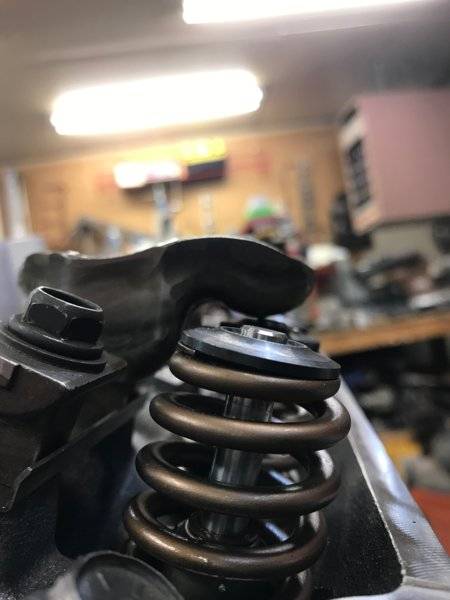

My buddy Mike is measuring for push rods and setting up the rockers for me today. Looks like it might take a bit of tweaking...
Need to shim the rocker mounts a good bit and order some longer push rods ... that’s what happens when you chose longer valves that just happen to be laying on the parts shelf at the machine shop

Just waiting for my friend to mill some custom pedestal shims to deal with the long valves, and still waiting for the oil pan to show up.... no big deal as it was snowing here today.

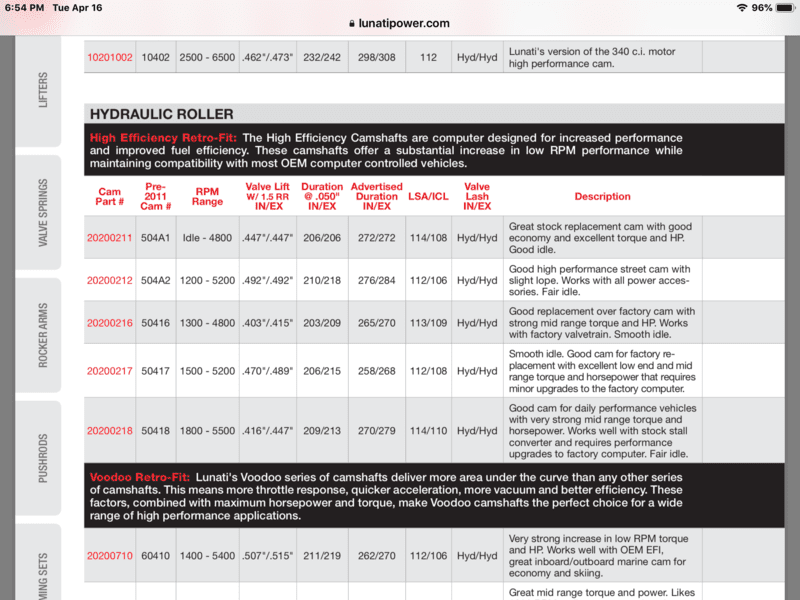

What is the general amount of preload guys are running on magnum roller lifters? We have around 65 thou with current step up...
Retro-Fit Hydraulic Roller. Good high performance street cam with slight lope. Works with all power acces- sories. Fair idle.
  • Advertised Duration (Int/Exh): 276/284
  • Duration @ .050 (Int/Exh): 210/218
  • Gross Valve Lift (Int/Exh): .492/.492
  • LSA/ICL: 112/106
  • Valve Lash (Int/Exh): Hyd/Hyd
  • RPM Range: 1200 - 5200
On these retro fit hydraulic roller cams when they say Gross valve lift, is that figured with 1.5 ratio rockers?
It’s always a question I ask who ever has it for sale.
Just because you never know.
I think if I remember it works out to around.525 lift with the 1.6 factory rockers with the Lunati cam I used.
I could measure the actual lift once the push rods arrive...
It’ll be lower due to pushrod angle and rocker geometry.
