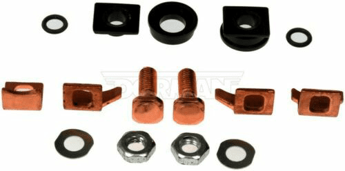

      I love the Denso in my slant six. Got it at a Mopar swap meet for $35. Put 12 volts to it and it worked so I bought it. Then 2 yrs ago, it just clicked, no spin. Went on line and bought 2 copper contacts for about 10 bucks. Put those in and its good again. Supposedly, that's about all that goes wrong with them.

          Solenoid contacts go bad. 3 screws on triangle cover and it's right inside. Super cheap and easy to replace.

              I think I paid $10 for the junkyard ones I took from Magnum engines, but I wait for half-off days at PicNPull. Measure the voltage right at the big stud on the starter, to the case of the starter. If it drops <10 V, don't blame the starter. Voltage drop could be in the ground connection from the starter's case to BAT-. You should be able to find the drop quickly. If >10 V, then blame the starter, which would likely be pitted contacts. Some rebuilders do a cheapie job, like re-using worn contacts, maybe flipping them around or such, but they do make the cases look new and shiny.
