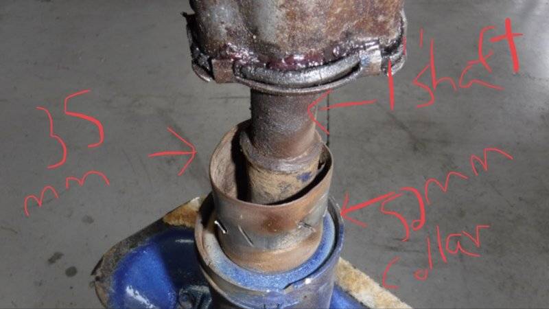

Is my steering column missing something to center the shaft on the housing? or is it normal for it to float like it is. I believe the gear selector leg was removed just not sure if that's what centers the shaft or if it's lacking another bushing or something. Thank you

Bearing is gone
pop that wire clip off and extract the plastic piece. Then you will see what's missing.
But really, for a manual trans application, that bearing doesn't hardly do more than keep bugs out and maybe some heat.
