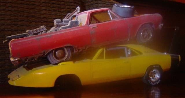

Before it was available I made a Daytona out of a General Lee model.
Later I sent it off to the junkyard and put a rusted El Camino on top.
I used a rust kit, I forget the brand, but it was 4 larger plastic bottles of different colors/textures iirc.
Model railroad paints have a pretty extensive "weathering" color set including rust and dirt.

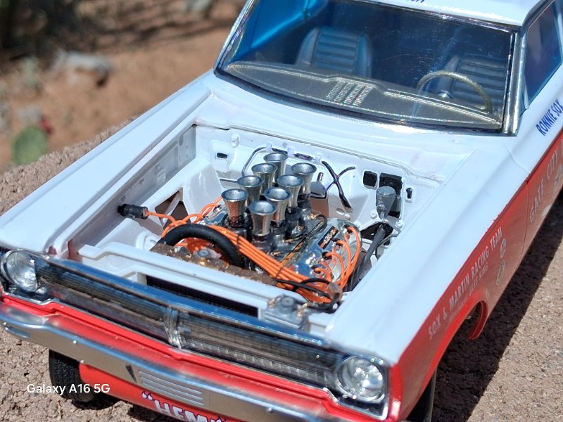

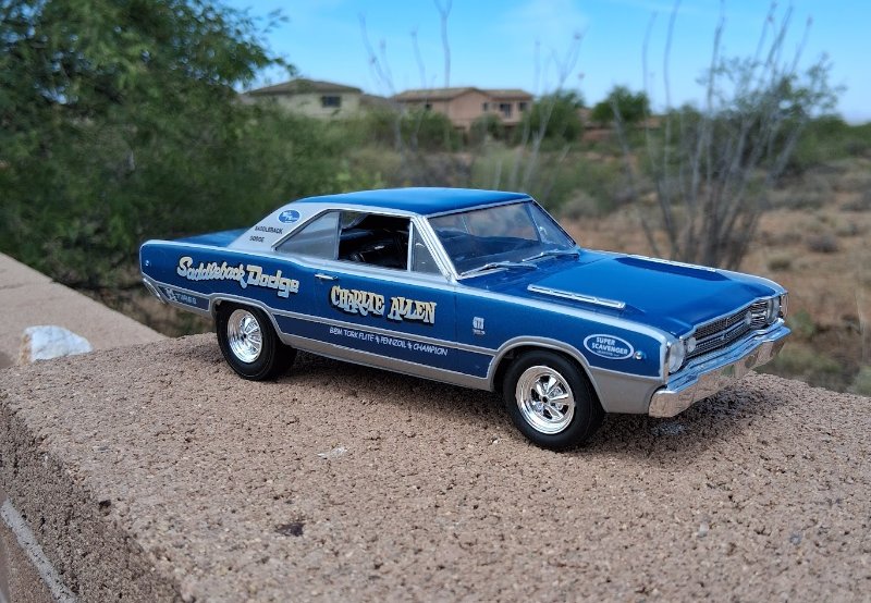

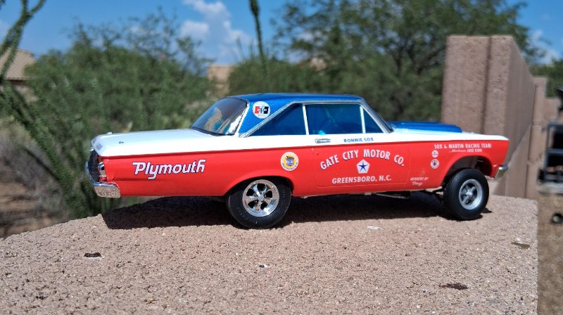

I built this one recently
Im primarily a box stock builder. But Occasionaly will do added details
Belts: sometimes I use 1/16" "art tape" - Hobby Lobby; sometimes acrylics, sometimes a paint pen or extra-fine Sharpie.
Plug wires: I like Morgan Automotive Detail's products - different colors of wiring & caps & cylinder counts.
