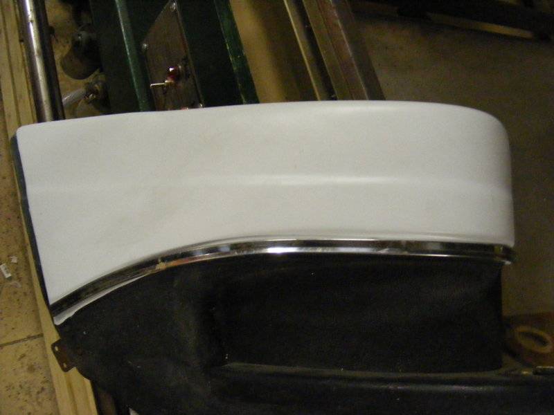

those are all the pieces I'm getting ready to run Sunday(hopefully I can figure out ho to cut the glove box and the larger outer side pieces out.). you don't mind white ones do ya?
Nope, I have lots of paint and plastic dye.
Are those white and black panels the rear interior panels? I would be interested in a set of those as well as mine are showing thier age these days.
just the white pieces so far.(top 2 pictures) The larger complete bottom piece (3rd picture )is in the works but it won't be exactly like stock. (wrong grain and 3/16" thick ABS, so it'll never crack and discolor on the bottom part again.)
this piece is slowly coming together but still needs work to get it right.
