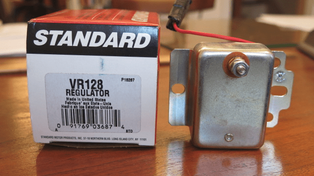

You can buy what looks to be the same regulator from NAPA and Standard, except its not painted.
In my experience failures seem to occur when used with squareback alternators, particularly revised squareback alternators.
That's not scientific or statistical, just my observations.
I contacted Standard's tech line, and the guy couldn't find any specs for it. All he could dig up was a dimension drawing. But considering these were intended as replacments for Studebakers, there's no reason it would have to handle field currents of 4 to 7 amps. A revised squareback can draw 5 amps or more if I recall correctly. So can a VR128 or MP regulator survive that long term? I don't know.
