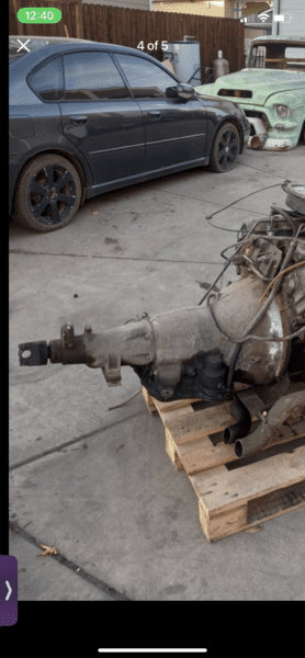

Hello everyone I am wondering if I can make a motor home 727 work in a 73 duster. I am a highschool student with a small budget. I am looking at a motor home 413 with a 727 attached to it. I am curious if I can make the 727 work with out swapping the output shaft. I can post a couple pictures. I’m trying to build this car on a budget. If you have other suggestions feel free to let me know.
Big Block Mopar transmissions, 383-413-440 etc., like the one you have, will NOT bolt up to a small block, 318-360 etc. if you don't already know, & are running a small block engine in you Duster. They have a different bolt pattern (Sadly) on the block. If you ARE running a Big Block, what RRR said.
IIRC the length of the driveshaft would necessitate a carrier bearing possibly. I've swapped the tailshaft before and it's not that difficult plus it gives you a chance to see how beat your clutch packs are.
You can use it as is like said above, but will need a custom slip style driveshaft made. It would likely be cheaper to change the tail shaft and housing for the correct one. You can also then use a standard driveshaft. Or shop for another 727, this time a car, long tailshaft style. I found one locally for $100 when I did mine, and converted one from MH to car. Best of luck
Change the length. You might be able to find a stock driveshaft to fit. It would be cheaper than having a special shaft made. Didn't those mh 413s have weird heads and exhaust manifolds that won't clear in a Duster?

With a fixed yoke like it has, he would need a slip style 2 piece driveshaft from a truck or something else. Finding the correct length may be a challenge.

No kidding...I keep saying to change the tailshaft and tailhousing; to be able to use a stock driveshaft.. I've seen tons of cobbled up jobs that were meant to save money and trouble; but just ended up costing more and not working out. Wouldn't it be hilarious if the op makes up a special driveshaft ($$$), then finds out the trans has to come apart anyway?
