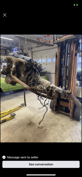

Hello I am wondering if motor home 727 (65-78) are different from ones that came out of cars. It would be going in a 1973 duster with a 440
this is the trans
Yeah, I'd pass on that one. It would cost you more to convert it to pass. car use than it would to just get the proper one to begin with.
Can you grab a standard 727 tailshaft and bolt it on? You don't need that brake. Not sure if the internals have the parking pawl. Trans guy would know...mechanically. :p
You will need three things; longtail output shafft, longtail extension housing, and front planetary to make sure that the splines of the planetary match the shaft. You can use a small block, AMC, or International Harvester for the parts.
That trans has the beefier planetaries, and may have better bands in it. Swap the tail shaft and housing and you should be good.

i have a 727 motor home tranny that has been taking up floor space for years.
Are you guys telling me it is worth keeping around as it has heavy duty internals?
mine has the brake on the back as well. It also came with a steel crank 440 attached
It's worth checking out.
Is that a bolt on yoke? But that would work even so, but you might have to deal with sealing up the back of the yoke. What does your tail housing measure? It looks a little short from an ordinary car. And I can't see if it has the double nubs for the factory shifter bracket.
The one I ha
the one I have is a bolt on style but the output shaft and tail housing are made to support that emergency brake.
Wait
The one I ha
wait a minute,, maybe it’s a trans brake???
That would be funny if... Anyhoodle, it's value is the fact that it's a bb case, and probably a 71-78 casting with the ptk valve body.
