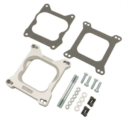

I have a 75 850 TQ (larger secondary) that I would like to mount on dual plane square bore intake for my small block 360. Going to be a learning experience including the TQ rebuild. This is strictly a street engine. Hood clearance may be a factor with the tall manifold. For those who have done this, what are you using???
I was thinking of the Mr Gasket 1932 and hog it out if necessary. I did shave down the plenum divider a bit on the intake.

That adapter (any adapter like that) is a power killer. If you want to run the TQ, get a different manifold.
Again, those things cause more issues than can be fixed.
If it's for a dual plane get one with the bar right down the center, to keep the distribution as close as possible to stock

I tried the 850 on my 360HO with the AirGap and adapter.
IMO; for street use with street gears, this combo is a waste of time.
I tried several other carbs as well, but I found the 750DP was about the best on my combo, if a little large.
However; that same 850 on a proper small-port 2P intake, is dynomite on my Smog 318.
If you try this, make sure the secondaries don't snag on the adapter, at WOT! That adapter, altho it works, the transition is just too abrupt. Mine needed a thick gasket for secondary clearance.

I'm setting up a dual TQ set up for a 426 wedge, the Edelbrock 4 hole adapter looks to be the least restrictive and best matching. As you can see here, the adapter positioning will cause uneven flow and turbulence as it hits the metal between the 4 holes using the Mr Gasket adapters .the Edelbrock 4 hole adapter will be a closer match to the existing 4 holes on the intake.
Yes I know that the air gap is not 4 hole but I think it would be the best existing match if you can't find an adapter with a bar down the middle Ithe 4 Edelbrock is $ $33 on Amazon
