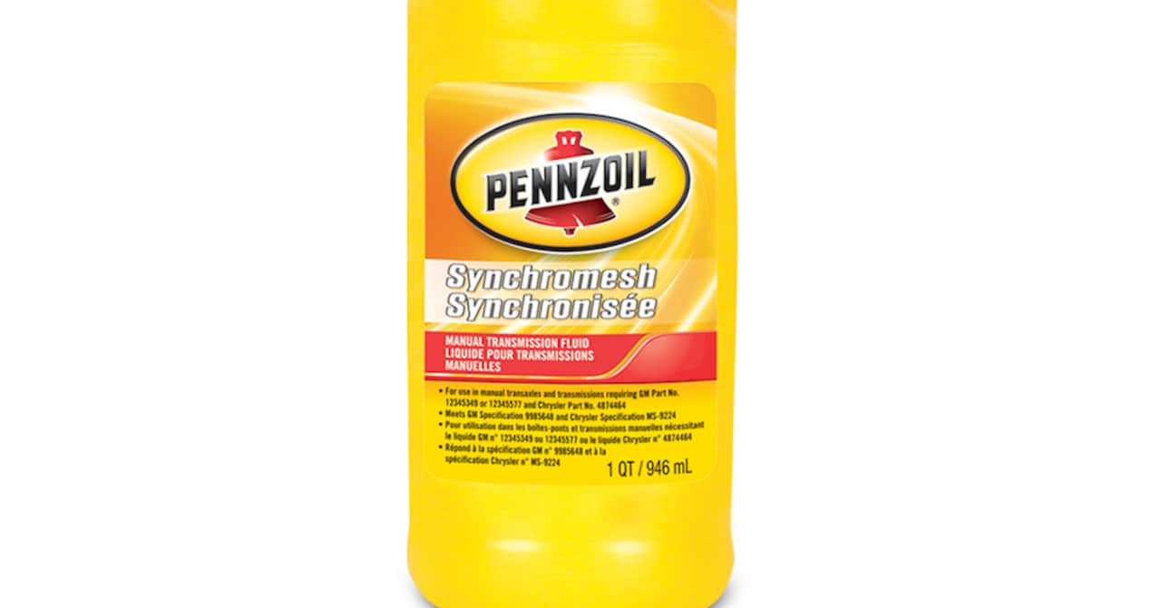

I have run the Pennzoil Syncromesh. It worked great.
