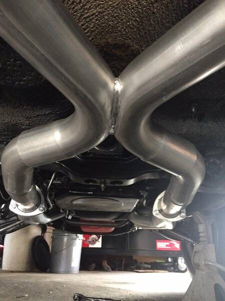

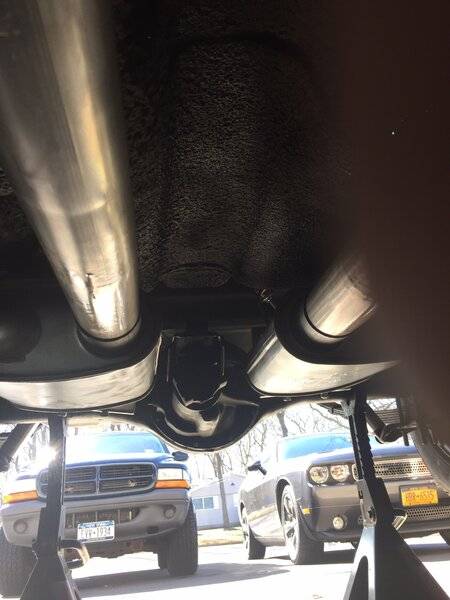

Dynomax turbo’s, 14” IIRC, I have the full TTI headers to tips, 2 1/2”, x-pipe crossover,
The mufflers that come with their kits.
TTI muffler hangers from Stock dual exhaust chassis mount.
I later put TTI stainless tips on it.
Full TTI system.
Off set in, center out, IIRC, 14 inch muffler case.
