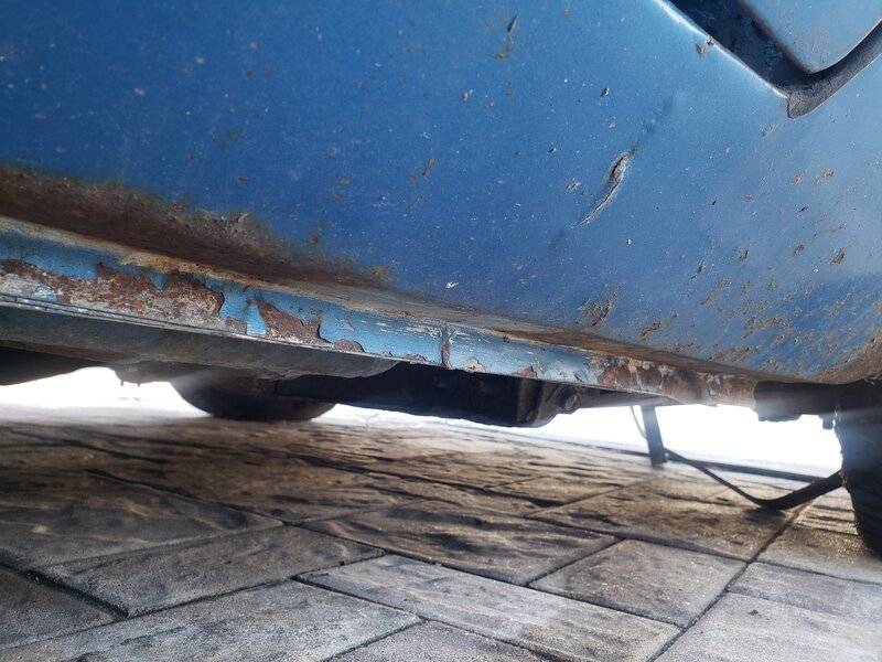

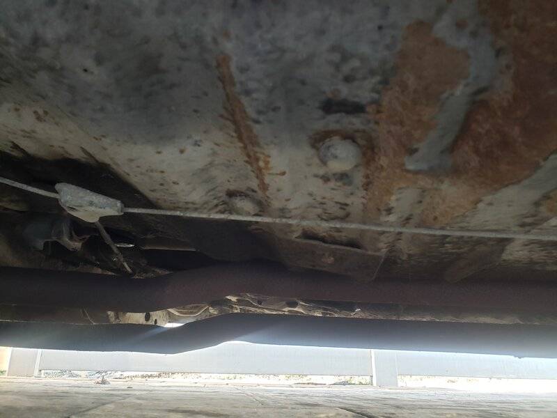

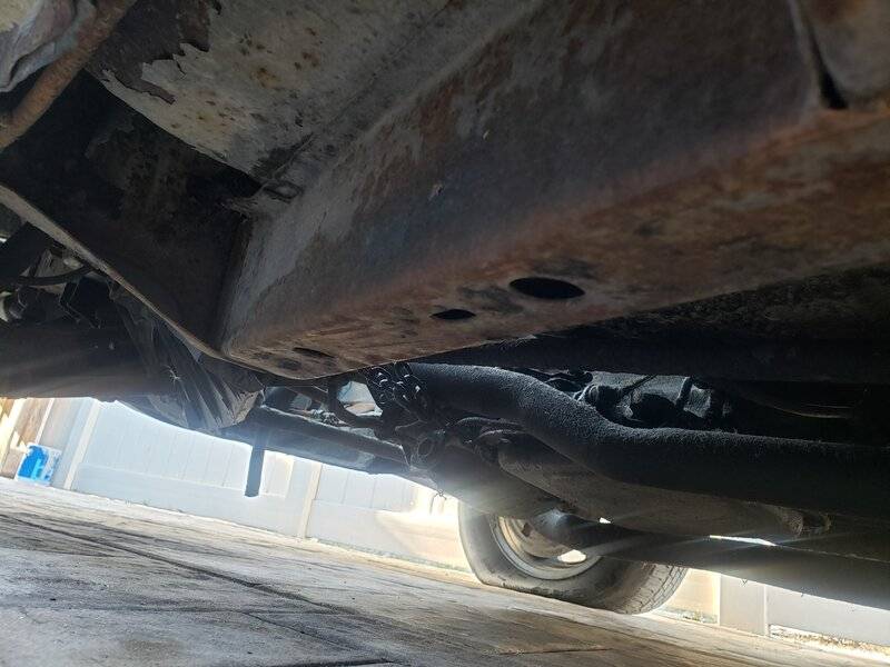

just acquired this Barn find thanks to a close friend.
Should be a fun one. 1973 Dodge Challenger Rally very strange car full rally tictoc gauges,
Air conditioning B5blue disc brakes power, had white top white interior column shift and found inside a complete floor shifter and console. Front fenders were sticking out of shed and cover was deteriorating NO FLOOR RUST OR TRUNK RUST AND ENGINE BAY IS CLEAN WITH ORIGINAL MARKINGS ON INNER FENDER. ALL ORIGINAL CAR. AND 318 engine weird but that is how it was ordered. Engine out and on stand.

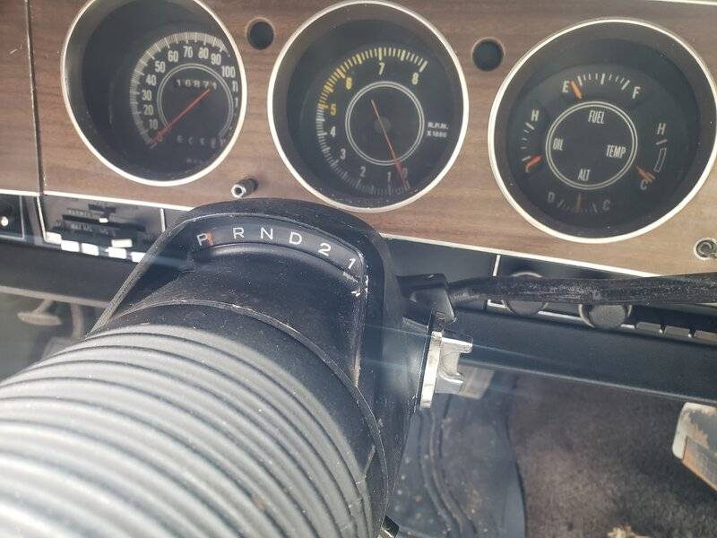

Nice find. I like Challenger's The column shift is rare. Odd it has 8K tac should be 7K. Actually looking at it you have a '70 Ralleye cluster.
The 8K could have been a last years left over. Not to many came that way. I wouldn’t call a tree shifter rare, just not so popular.

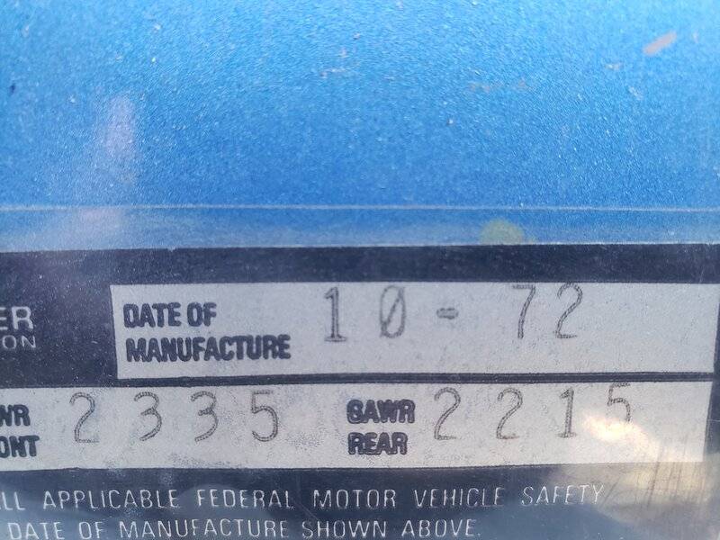

Door tag manufacturer date 10/72 might be very last or very early 73? Again very odd things I’m thinking

Would that have been a whole years leftover? They went to the 7 grand tach in 72, no? after looking at the pics again, that's a whole 70-71 cluster. The clock and odo resets are through the woodgrain, not through the speedo and tach lenses.

You are correct it is a 70/71. It's not a leftover. Seats shouldn't have hard backs. Cool car though love the colors.
