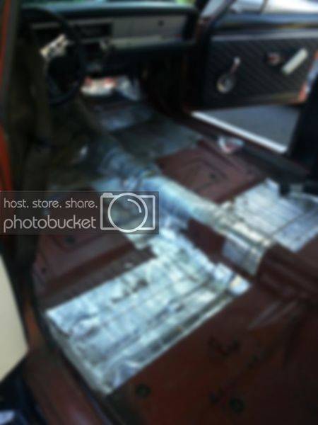

First I ripped out my temporary autozone special carpet (that was in the car for 2 years...) and cleaned up the floor pans. I did not opt for using spray adhesive to hold the carpet down, and opted to fit everything just as tight as I could.
I hadn't cleaned the old carpet in a while knowing it was getting tossed out...
I used this opportunity to rearrange some wiring, and tape other stuff down, vacuum, and then got to fitting the carpet in the car. Surprisingly once it was down on the floor pan, you could see where the pan was defined into the carpet, and it got pretty easy after that.
I had a lot of patience and scooted it to where it matched the floor pan. To me it doesn't seem far enough forward by about 1", but this is where the pans and the carpet match up perfectly. Also the heel pad is a little far over to the left by about 1.5", but there's no way to scoot it once you find where it fits right, it will always return to this spot, and it looks bad if you try and move it. So once I had it all laid down I trimmed it to fit under the door sills, and left it long behind the kick panels since I didn't need to trim it there. In total at the door sills I let the carpet go all the way to the screws in the sills, so it's pretty long, and then trimmed off about 4" of carpet from both sides, so I was sure it was in the middle where it's supposed to be. I did not trim anything front or back, I just made a slit provision for the gas pedal arm, and poked "X"s in the carpet for the foot pump and the high beam switch.
For me the heel pad being off a bit is not a big deal, because it's not necessarily a show car, and I am going to put some rubber mats over it anyway. It is loads better than the old carpet. Like I said, I tried to reposition it, but that's just where they stitched it on...
