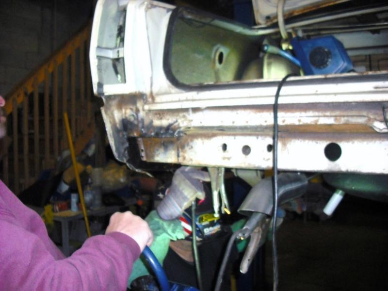

Very cool, where did you get the trunk extensions and lower quarters? Are they Valiant parts or for somthing else?
Always nice to see another Valiant project, especially another 69. And I remember when you mentioned one to other car guys, even Mopar guys, and they'd look at you funny and go "huh"?
Now they are everywhere... and I couldn't be happier.
Good luck on your project.. keep us informed on the progress... some of us need isnpiration..
Alan

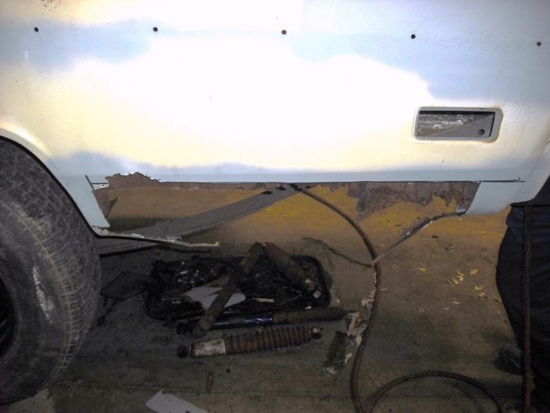

Vitamin c They don't make anything for valiant. I got the trunk extension and lower quarter patch from Classic Industires both are AMD parts,70-76 A-body trunk extension# MM1424 and quarter patch panel 72-76 A-body #MM1459 Both worked great.

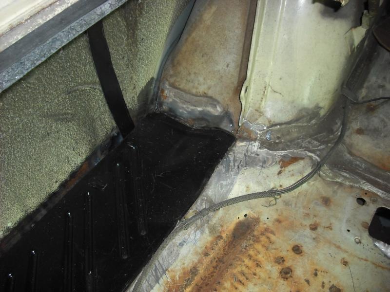

Looks pretty nice for a bucket-at least you only had to patch one and replace one panel...I still have a whole quarter, trunk floors, door and fender to patch...I hate rust :(
Yeah I also did the spare tire well,gas tank sending unit,3/8 stainless fuel line, and got all stainless brake lines for whole car not on yet. Waiting on new windshield gasket just ordered yesterday. Still have to get inner fenders and fenders change driver door. It keeps going. Lol
