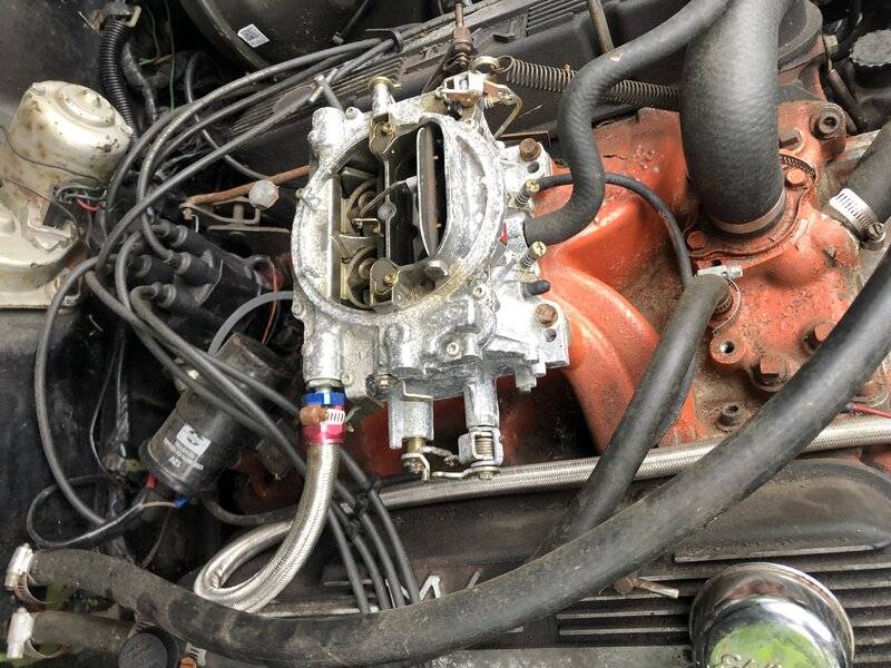

I have this on a parts car I just bought. Not sure what it is looks like a single plane. It’s edelbrock but I couldn’t find any numbers. What is this intake?
Edelbrock Torker2
Pretty good intake it’s tall plenum makes it midrange and top end power.
I use them and like them.
Look at the rear of the intake, between the rear runners, I do think very much that it is there you will find the words, “Torker II 340” cast in.

I have found out through the years of owning one that it can be a little difficult on the street with its huge plenum, (and wrong cam and gear ratio make it a PIA) but a good trick is opening up the runners to the port size as deep as you can go is a good mod. Also, given the intakes large plenum (for its size) that a 4 hole 1/2 or better spacer works really well. You can push it to 7K.
This intake is like a “tweener” (in between) manifold from the Performer and the race single planes like Edelbrock’s own Victor or a M1 or a Holley Strip Dominator. (All 7K and plus intakes.)
Since the RPM intake came out, beating this in power production all over down low and matching it or better up top, this intake has fallen out of favor. If anyone was working with a “On the Cheap” budget, or already have it on there engine, it isn’t to bad of an intake. Designed more for medium large cams and higher than normal gear ratios. You can make some decent power with it.

Parts car has a running 72 340 and a 8.75 with a sure grip. I think I did okay on price lol. I have a Couple air gaps on my stock as well as tunnel rams. I forgot they even made a torker for these lol. In the AMC world torkers are king. But they might be beat out by the new Vic Jr they just put out.

They are very handy for engines needing more RPM range and have hood clearance issues. A lot of the 429 CJ guys run these because the factory hoods and Shakers on Torinos won't clear a Stealth or RPM intake.
