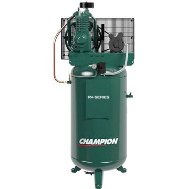

I agree with @toolmanmike. I recently bought a Champion compressor from TP Tools. My North Star compressor from Northern Tools lasted about 16 years. I really like the new Champion. It has slightly better air flow, and it is much quieter.

I have an older 5 HP Champion, 2 stage 80 gal. It is an excellent compressor, runs a pressure pot blaster with no problem.

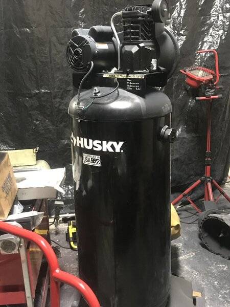

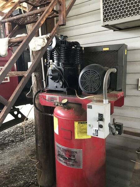

Lemme show some pictures of the compressor graveyard at work here. Been at my work about 8+ years and we use a compressor some but not really a lot. We’re on our 4th one. It’s only 2 guys in a shop.
The first one here lasted longest but really not much maybe 2-3 years
this last husky one has been a good one so far.

View attachment 1715542738 View attachment 1715542739 View attachment 1715542740
this last husky one has been a good one so far. View attachment 1715542741
Doesn’t say a lot for Husky does it?
Lol Home Depot is closest store and when the compressor breaks it shuts us down. Our CNC bender runs off air but not much. But yeah I’d say the husky brand isn’t so great. Maybe one step up from harbor freight. They just don’t make compressors like they used to.
