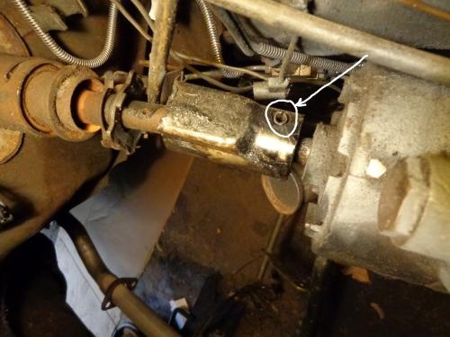

Punch out the roll pin shown in these pictures.
Also, you may need a helper to hold the steering wheel still while you pound out the roll pin as it will want to turn while you are pounding on it.
I believe that it takes a 1/4" punch to do this (it's been a while for me).
Here it is circled:

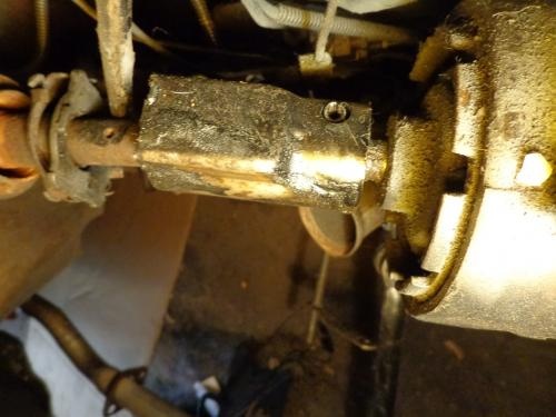

Here's a closer view:
Here's the close up circled:
Then pry the coupler off of the steering box.
