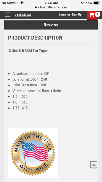

    im thinking about the .557 purple shaft ,or a custom ground ultra dyne/ bullet. I also have access to a clay smith 304 525lift solid cam, this is my first big block build

    I’d like some specs for the Clay Smith cam @.050. It is a low lift @ .525.
    Here is what I would do. Food for thought for you.
    Mill the cylinder head slightly for a 1/2 - 1 point in compression.
    Sell/Trade the rockers for a 1.6 ratio
    Use the MP Purple 296/.557
    New lift is .594 without lash adjustment. MP calls for a .028/.032. You could run tighter. But it will at least get that valve up into the heads higher flowing area.
    Talk with Mike (Member B3) about valve train geometry)
    I’d run the RPM. With a 1 inch open spaced if room allows. You’ll give up nothing to very very little on the top end but gain huge on the low and mid range.
    The 296/.557 is the largest cam I would use a dual plane on. Not a single plane. Not on a full weight or semi lightened car. Your ‘67 is not a light weight. (I have a ‘67 small block) The next size up Purple cam (at a min. size cam) I’d use a single plane with in a lightened car.

    thank you for the info I’ll consider it for sure , here are the specs on the clay smith cam.

    Oh heck if you can get 1.75 rockers, I’d run it!
    A slow lift lobe fixed via a rocker ratio change....
    Oh yea!

    That Smith cam will work fine.
    If the heads were previously run with a solid roller, the springs are likely way too stiff for a flat tappet cam.
    Have them tested to make sure the parts are compatible.

    yes I was going to remove these springs and get the proper springs, thought about running the same cam as the guy was selling it also but figured I would weigh out my options and with something a bit more mild than he had he was running a .630 lift cam

      The possibilities are endless, as you can imagine. This cam worked well for a 383 TRW dome poston setup I ran a while back. Trouble free and very strong. See if you can find a 1.6 Crane set and use 8 of them on the intake valves and your 8 exhaust 1.5s. This would give you .576/.563" before lash, and I used .022/.024" HOT setting.
      Drag Race Solid Flat Tappet Cam - Chrysler 361-440 316/326-1
