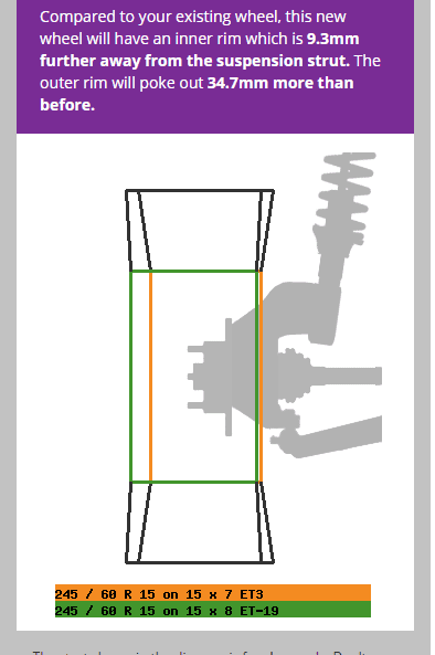

This site it a huge help for situations like this:
Will They Fit - Online Wheel and Tyre Fitment Calculator
Below is an estimate based on what you said for size and backspace(I calulated the offset).

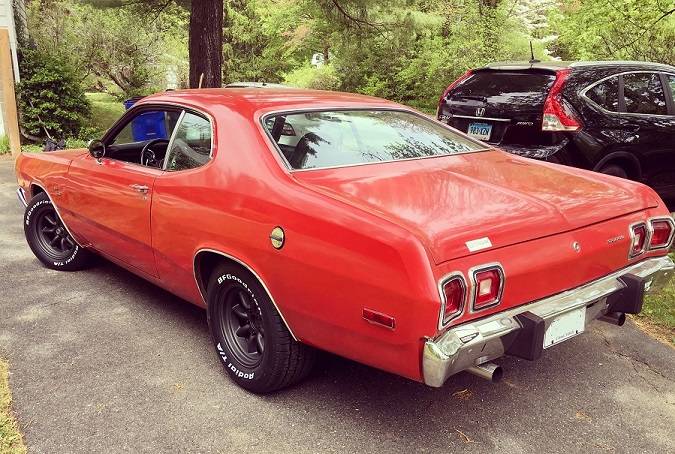

Not Cragars...but these are 15x8,+10mm offset with the (at the time) 7.25" axle which is just a bit narrower than a stock Abody 8.75". Tires are 255/60s
67-69 Dart rear quarter panels are quite different that the other A-bodys. They hand low and are not fully open like your Demon. See my car below. FYI it has 17x8 with 245/45/17's. I had to get a custom offset, as I have an A-body 8-3/4 with BBP axles. Even with that combo its tight.
