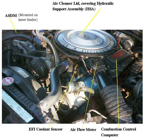

The previous pictures above are '81-'83 Imperial ONLY, not Cordoba. The Imperial system was a short-lived attempt at EFI, which was so troublesome that the factory came up with a kit to retrofit the carb system (ala the Cordoba etc.) under warranty.
I'm getting palpitations just looking at this.
Yeah, if memory serves (which ain't as reliable as it once was) it was a design from the French over at Rennault (remember that ill-fated cooperation?) and was kind of a patchwork hodgepodge of bizarre parts... It was intended to give Imperial a selling point vs. the competition, but in reality it probably just provided another nail in it's coffin.

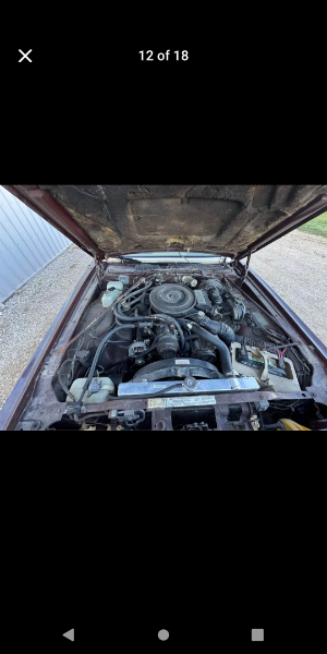

There's a host of unfamiliar stuff inside that pie tin! No wonder they wanted to hide it
I knew I should have opened that lid before I opened my mouth... What in unholy tarnation is all that nonsense? Though that does simplify matters.. if it's already carbureted, then I presume it's easier to throw a different carburetor on it. My next concern at this point is finding out for sure what kind of transmission it's got and making sure I can keep the lock up if it's got one. I'm pretty sure it doesn't have overdrive, but it was too low to the ground to find out for sure. On the plus side, it runs and drives and has 69,362 miles on it. That's that cliche Grandpa's Sunday car story. it's got a new alternator and radiator, but the fan belts still say mopar
