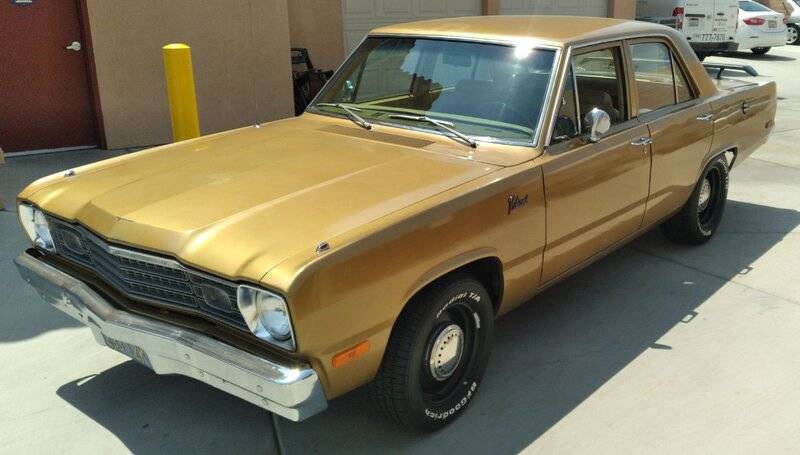

      Here is a video of the issue, first burp pushing pedal down, once its bottomed releasing causes the 2nd burp. No air in the system.

      Anyone know what the issue was with the master or what might be causing it to do that?
      I sent the master back today, ordered one from Classic Ind, along with a Combination valve.

      Something had to be causing the fluid to go low in the front to higher in the back reservoir, that cant be normal.

      The 2 cylinders are internally tied together via passages. If the pistons are at the wrong places they could pump fluid from one resivour to the other.

      Changed the master with a new one today same issue but not as fast. I bought a new combination valve but tried the master first. Not sure what else it could be? This is the same master cylinder that is on my buddies 75 duster with power brakes and his works fine.

      Leak in the rear .
      Air in the front .

      Yes I did!
      Ended up being the proportioning valve. I purchased a new one from classic industries. When I got it I disassembled it to make sure it had no burrs and give it a clean. I then pulled the old one off and it had markings like it was rebuilt. Took it apart and most of the internal valves and sprigs were gone! and on top of that it was filthy. So this was the reason it was not functioning correctly. Kinda surprised it my brakes even functioned for the year I drove the car.
