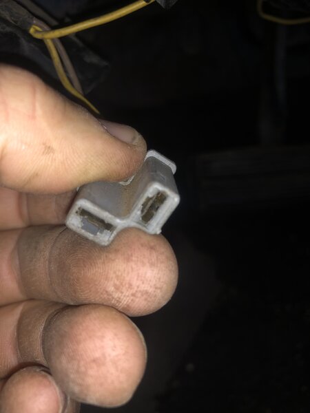

Hey guys, another question here. Working on my sons 73 duster. It’s a wiring nightmare that’s new to us. I have a good wiring diagram but I’m have trouble with a couple of things. There are multiple things that don’t work in the dash, blinkers, emergency flashers, key buzzer, oil light brake I dictator light and blinker indicators. The blinkers were half working and now most are just solid light. Anyway I have some plugs dangling without homes. I’ll attach photos. I’ve got one down by the driver kick panel. Looks like a grey and blue wire. Then I have a black plug with blue wires going into one slot and a blue with white stripe on the other side. Then I have a little grey plug with brown and yellow wire. Those last two are dangling behind the fuse box. Let me know if someone know what these go to!
Photo 1 looks like seat belt body connector.
