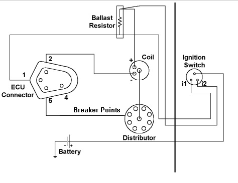

This is the ignition circuit.
is someone firing a ECU with breaker points
:rofl: I think it can be done so don't get me wrong.
This should do ya if you have a 4 pin ECU
and this if you have a 5 pin

Oh well,
I get use to these drawings be so generic I didn't really look at it, I didn't have the one I like with me so I just did a search a grabbed one.
Alan
I've done the same.
I still think it would work.
Schematic is functionally correct but the cavity positions in the bulkhead connector are '67.
Not that it can't be done, but if all that you have is what we see in the picture, you can buy all new harnesses, there are about 4 main ones, plus.
