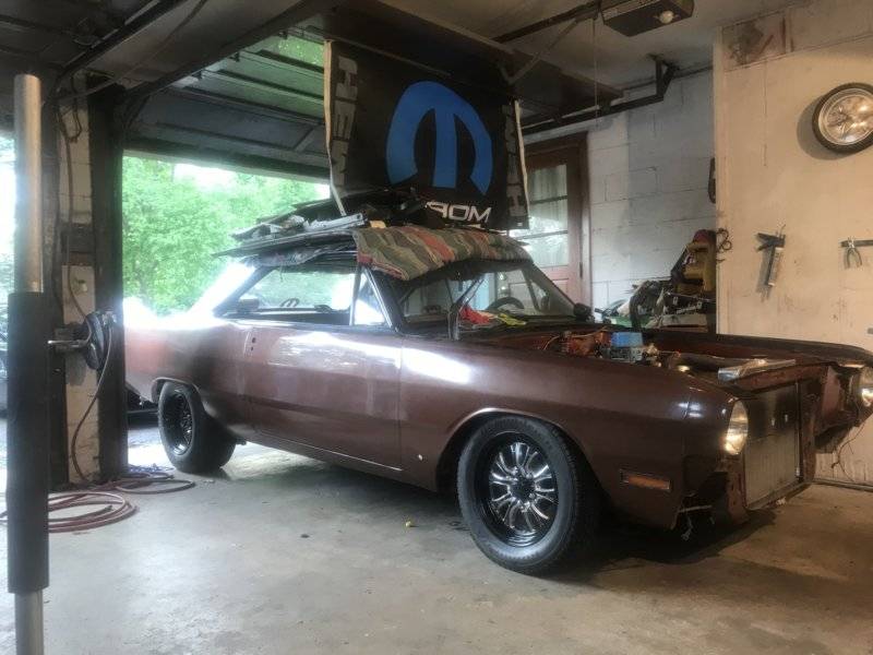

Well it’s about time to fire up my new motor. It’s a 70 340/418 I have tons of stuff done to it. Block 40 overs decked 40 because it had old school o-ring on the head Surface scat rods a 4 inch scat crank Diamond piston flat top pistons lunati can 242 in. 252 ex .
Prw 1.5 rockers. Super Victor intake port matched the intake. Biggs 4150 750 dp trans is 904 reverse valve body edge race converter 9 inch 3800 To 4000 stall With b&m Rachet shifter. QA1 front end coil shocks rear
Riley motorsports 4 link on the back
