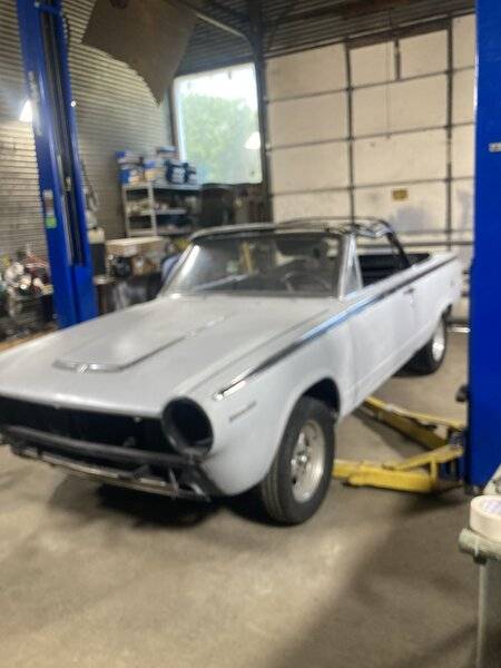

So, my son and I are doing a new build after putting together my old 69 Dart 440 car. Wanting to do turbo fuel injection project.
Looking for 250-300 hp
Heading to Mopar Nationals next week and looking for “stuff” and knowledge for the build.
Car : 1964 Dart Convertible
Block - 2806830-7 1714 BH
(Obviously not original)
Transmission 904 push button. Want to keep with adapter ring for late model snout.
- would really like convertor recommendations -
We will go through transmission.
Rear end - just finished narrowed 8 3/4 489 case with 3:23 gear and mini tub. New XHD leaf springs. Shocks not purchased
Front end - Qa1 upper and lower control arms and strut rods. Hotchkiss street shocks
Brakes 4 wheel disc.
given the set up what would YOU do to this 225 slant 6 for
