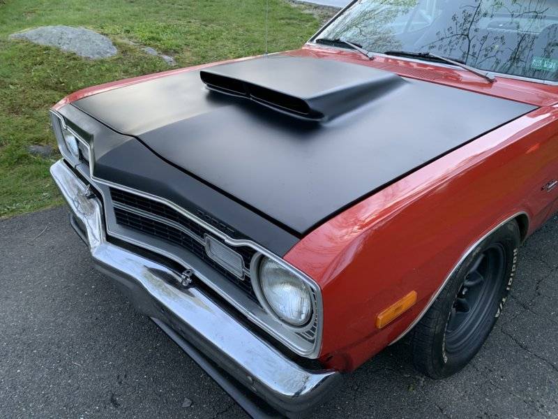

Maybe I’m a bit dense but I’ve gone around and around trying to adjust the mounting points on the hinges. I’ll fix one side and then it’s messed up in a new, exciting way.
Is there a trick? I plan to keep messing with it but I feel like at some point In ~50 tries, I should have gotten it to sit properly.

Is the hood sitting on the bump stops in front on both sides in the picture? The latch should be adjusted to hold the hood down on the stops on both sides. If the right side of the hood is on the stop and the left side is not, lower the latch to pull it down. If they are both on the stops screw the left stop in to lower. Are you using factory springs on the hinges? If so the tension on the hood is probably warping the fiberglass - you need "light" springs or it will eventually screw up the hood all together.
