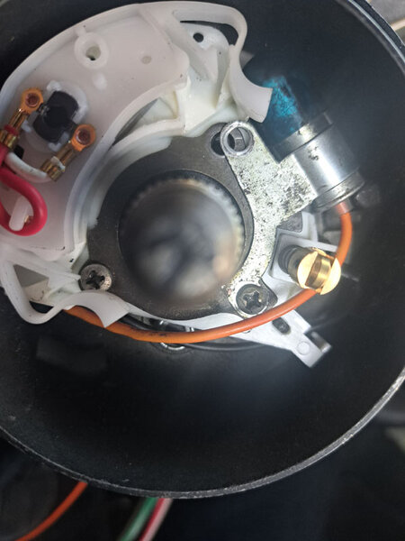

I bought an OER turn signal switch ($75) from Summit for my '67 notchback Barracuda and went to install it only to find the light bulb assembly will not fit. The bulb housing hits the new plastic switch making the top screw hole lineup for the bulb no good. Anybody else have this problem? It should fit first time!!!! I've done a few of these over the years and never had a problem. I went back to the old switch and it fits just fine.
I'm thinking that switch is made for a console shift car that wouldn't need the illumination bulb for the gear select indicator.

Heres the modification needed to make it fit.
Doesnt the wire/bulb/socket, pull outta the metal holder with screw hole.
Can't you just pull bulb etc outta the new "holder" to replace it with the original holder that fits ?
