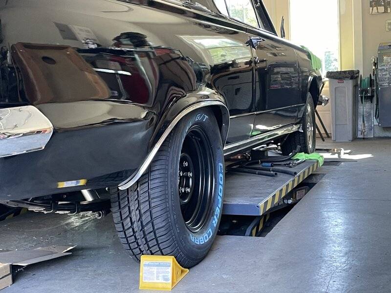

    Just got my tires and rims mounted. 15” rims 235 70 size tires.

      Can I get the rim size and offset of them?

        Me too!

        15” 4” backspace large bolt pattern and they just fit!

          One more number please...Rim width?

            7” rim.

              Looks great, same size front and back?

              Early A's look great with good sized 15's. Yours looks great. 15x7 with a 4" backspace fit good.

              Forgot a few other details. Had a 7 1-4 rear. Upgraded to 8 3/4. ESPO 6 leaf leaf springs. Stock location. Don’t know if someone makes say 4 1/2” back space 15” rim. There’s about a inch of space on the inside by the leaf spring and about an half inch on the outside of the tire by the inner fender well. And there’s no weight in the car. Fuel tank is empty. I just bounced the car using the bumper and the outside of the tires clear the inner fender well. Won’t really know till I get it on the road.

              A-body 8 3/4 or b-body? If A-body, how did you get to big pattern?
              Looks great, a little more backspace would have been better, but sometimes you can't get exactly what you want/need.
              Gonna run poverty caps?

              I’m waiting on 15” x 6” rims. BBP then I’ll do the brakes.

              Rear was built by a guy in Michigan. I just added the brake lines.

              Tried to PM you, your inbox is full. Question, what source did you use for your steel rims?

              I bought them from Jegs. I believe it was a 5 month wait.
