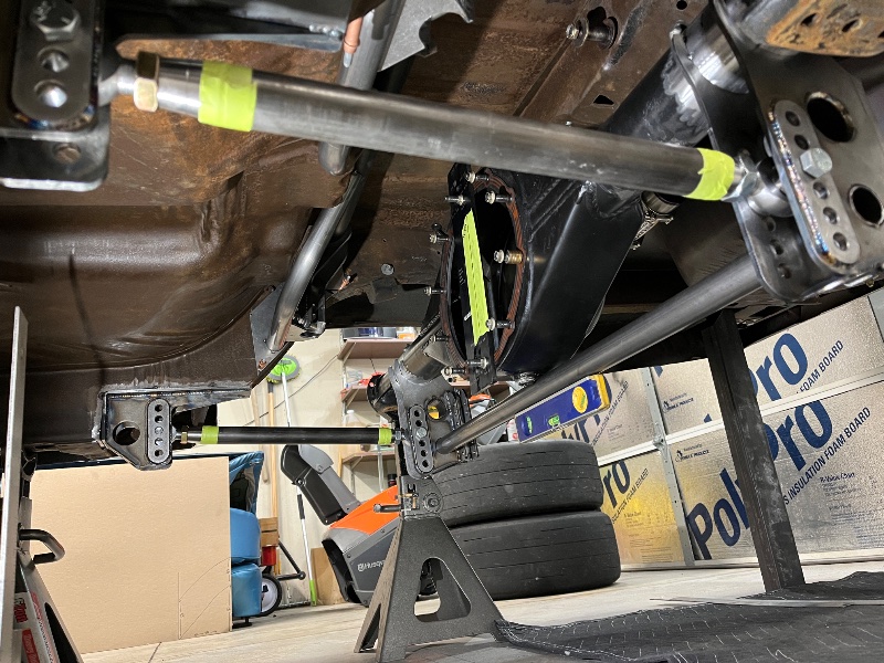

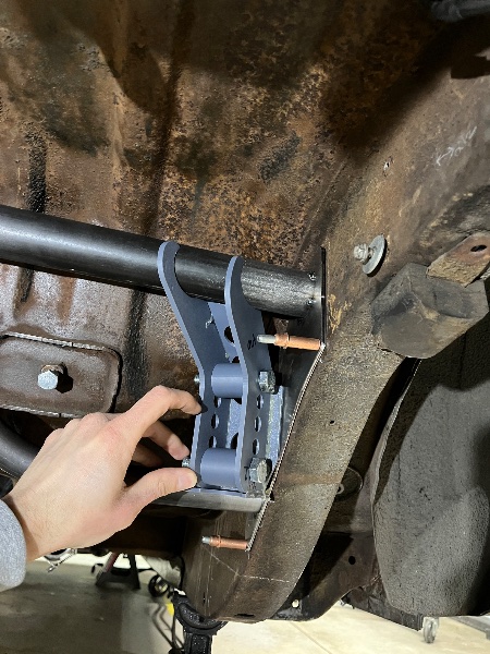

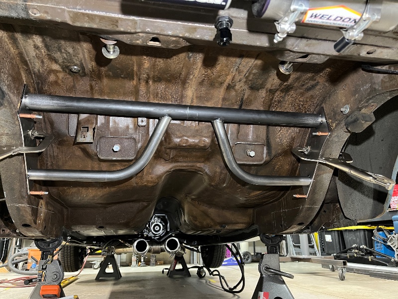

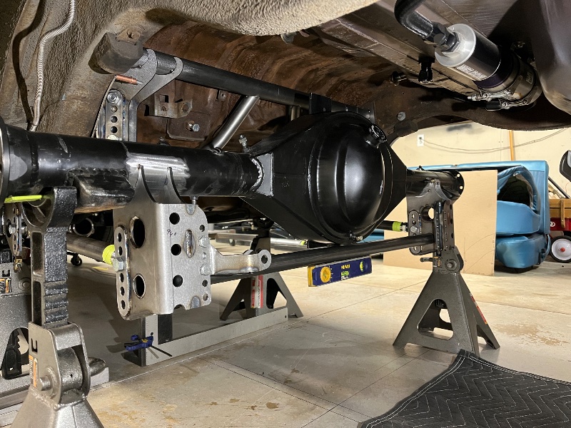

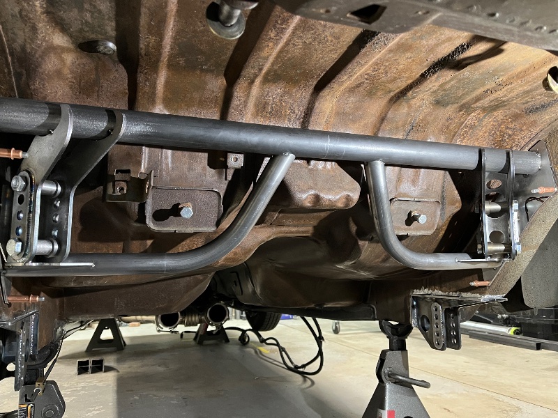

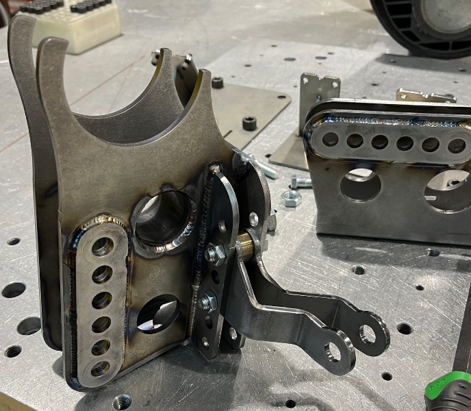

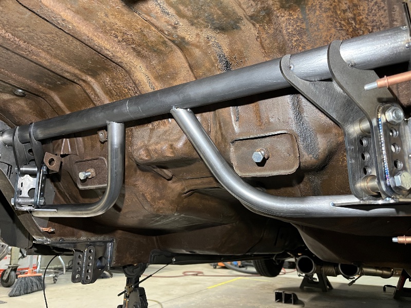

Since the the foxbody platform and triangulated four link works so well I had a thought of making one fit my 68 dart.. I wasn’t really a fan of the ones that where out on the market where the links end up in the middle of the chassis pulling on the center of the tube.. asking to bend or ripped out of the chassis with a good clutch dump or trans break launch.
Here are some pics so far. I will keep updating this throughout the build. The car will get a 6 point to tie in everything well. The car is a gen 3 hemi with tkx 26” slicks, 9”

I’m hoping to get them a little longer than mustang Around 10” upper and 18ish lower
Great job!!!
I took a lot of inspiration on my build from those Fox body and G body cradles like you are building. I found I was able to get a couple more inches on my upper bars by mounting the brackets on the housing brace.

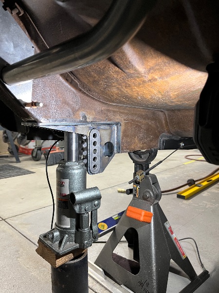

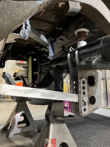

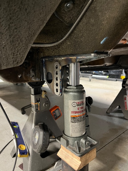

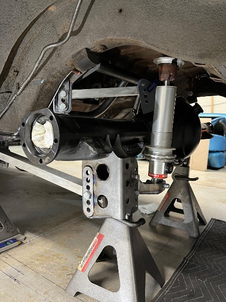

Little bit more progress. Gots some mock up lowers in there. Next is set pinion angle then the upper housing mounts. Then Coilover mounts
