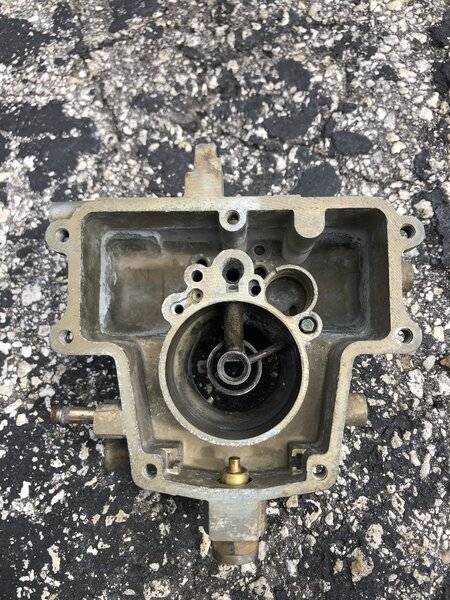

5. My carb didn’t have the ball bearing fall out when I turned it upside down. Where does it go? (One came with the rebuild kit I got from Mikes Carburetor parts)? If someone could put a red dot on where it goes in the picture I’ve attached I’d appreciate it. So many holes!

Pump well fills from top no check ball at bottom, discharge has check ball under brass wieght.

I'm not sure if anyone else noticed, but it looks to me like the brass weight is still in the carb body in the picture posted by Mako21. I seem to have lost the check ball brass weight from my Holley 1945 this last weekend as well.
