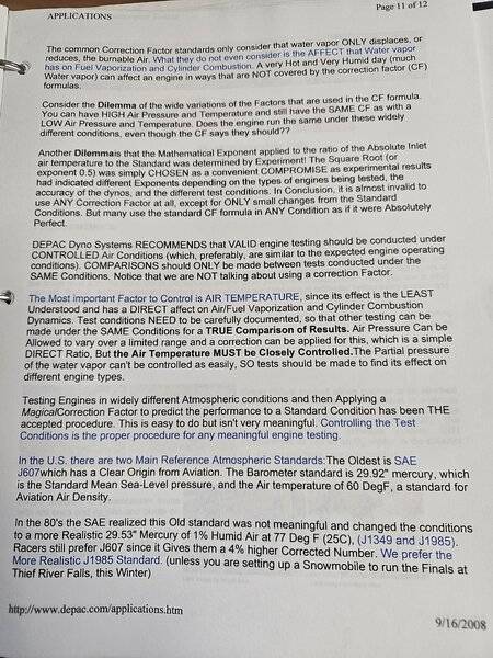

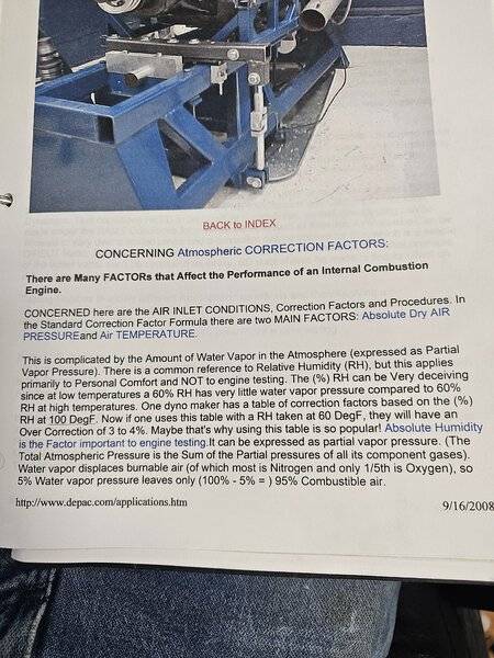

Depac Dave's thoughts on correction factors. For what it's worth. Hope this is readable.
The more you have to correct the more likely your correction is not accurate. Correcting to the standard that is closer to the actual conditions increases the likelihood of it being accurate. A correction factor of 1 is ideal.
More accurate than what? The ONLY time an engine makes the power the dyno says it does is when you use observed numbers AND the weather at the track matches the weather like it was on the dyno OR when using corrected numbers the weather has to match.
It doesn’t matter which CF you use because IF you are going to live and die by corrected numbers any corrected number has to match weather conditions at the track.
You keep saying the higher the CF the more inaccurate it is. My question is by how much? 20%? 2%?
I don’t know but I’m doubting is more than 2% worse case scenario. If that.
Also, most flow bench software I’ve used corrects to STP.
Why not correct to 90 degrees, 80% humidity and a 29.0 barometer? You’ll see more days at the track with numbers like that than ANY CF I’ve seen.
I’d argue (and do) that the CF is not the reason why dyno numbers are all over the place. It’s shitty dyno operators that have sloppy methods or they are just outright lying crooks.
Yeah, so???? He’s not talking about CF errors using the same CF across the country or around the world. He’s talking about an inherent flaw in the CF and it’s the same error regardless.
And that error only affects the actual power the engine makes. In other words, if we both use the same CF our numbers should match. You can
test in Denver in August and out here on the west coast in October and the corrected numbers should be the same.

"More accurate than what?"
The correction factor that is closer to the conditions during testing is more likely to be accurate than a correction factor that is farther away from the conditions during testing.
Edit: What part of this do you disagree with?
All of it. Use whatever CF you want. Whatever CF you use, it’s only correct when those conditions are matched at the track.
There is no perfect correction factor.
If accuracy is what you are after, the Performance Trends makes a weather station and software that uses the observed numbers and the weather at the time of the dyno and compares those conditions and numbers with the weather at the track that day.
Then it gives you the actual power the engine is making on that day at that time.
Notice it doesn’t use corrected numbers. There’s a reason for that.
They are already correcting the numbers at the dyno based off the weather at the dyno. They can correct using whatever standard you want them to. The likely most accurate numbers will come from the correction factor that is closest to the weather conditions at the dyno and racetrack.
I guess I didn’t explain it well.
The Performance Trends Weather Wizard doesn’t correct anything.
It uses the observed numbers off the dyno and the weather for that pull and then compares the weather at the track against the weather on the dyno.
From the OBSERVED numbers it recalculates the power number to the weather conditions at the time you are going to make a pass.
It has nothing to do with any correction factor because as I said, unless the conditions are exactly the same between the dyno and the track the CF doesn’t matter.
