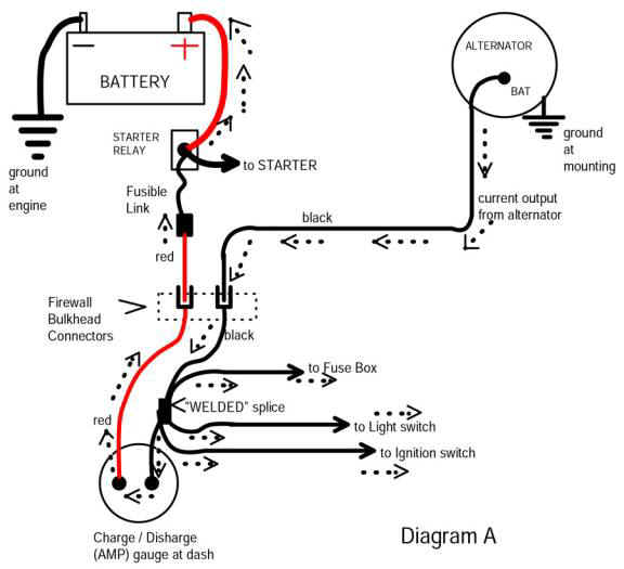

Here is a simplified diagram from MADD Electrical concerning primary power
This varies year to year, but it shows the general plan. Power from the batt goes through the RED, fuse link, through the bulkhead connector, and to the ammeter. Through the ammeter, out on BLACK, and a few inches from the meter, a WELDED SPLICE branches off to feed the fuse panel hot buss, the key, the headlights ONLY power to the light switch.

I am thinking either the wiring has been hacked (modified) or you made a mistake, or maybe the link somehow made brief contact as you were wiggling stuff. You look at that diagram, here's how the headlights power works
Again, battery comes on the big RED to the fuse link, through the bulkhead connector, and to the ammeter. Through the ammeter, out the big BLACK, and a few inches away, the WELDED SPLICE. ONLY the headlight power comes off the welded splice, directly the the HL switch B1. The light switch has a breaker built in
Tail/ park/ instrument power comes from a fuse in the panel, which is fed through the welded splice to the fuse panel "hot" buss and the fuses that are hot at all times.
The diagrams, some hints. Find the fuse panel, page 8-99, and look at the right side of the box marked "battery" the two on the buss. This is your panel hot buss, the stuff like brake lights, tail, hazard, that are always powered. Follow Q3-14R up and left. You will find the big splice we are calling the welded splice. You see R6A-12BK that is coming from the ammeter. If you are unaware, R6 or R6A is the circuit, 12 is the wire size, and BK is BlacK.
If you go up near the top of page 8-98, find the ammeter you will see that black, and on the left, A1-12R, which goes to J in the center group of the bulkhead connector. That is battery power coming inside from the fuse link, and should be the ONLY power coming in to the interior
Find the light switch about 1/4 of the way from the top of 8-99. B, or B1 at bottom left is the headlights only power Follow L1-16BK down and left it goes right to the welded splice
Im not sure Im understanding the flow of current, you are saying that it flows from the battery through the red towards the interior, but the diagram shown here shows it flowing towards the battery, and the alternator supplying the current to the welded splice. I must be missing something basic here.

Current flow is most commonly thought of as "electron flow" so yes, neg to pos. But for explanation it is often simpler to start at the battery and work from there. The functional path, whichever current flows, LOL
And the diagram does not follow, either, because they are showing current from the alternator, and the from the welded splice to accessories. So the shown current flow is ambiguous. The main thing is to follow the path like a road.
And to make it more complicated, the ammeter can flow both ways. When the battery is supplying current because either the engine is off or the alternator is running to slow to keep up, the ammeter will show discharge, but when the battery is charging, current flow in the battery / alternator relationship will be in reverse.
Current (electron) flow from any load, such as lights, will always "actually" be from battery neg---to body ground---to harness grounding wire---through headlights---through dimmer switch---through HL switch----to welded splice---to ammeter---and if alternator is more positive (charging) that battery to alternator and back to ground and all over. If alternator is not putting out, then current will end up at batter +
