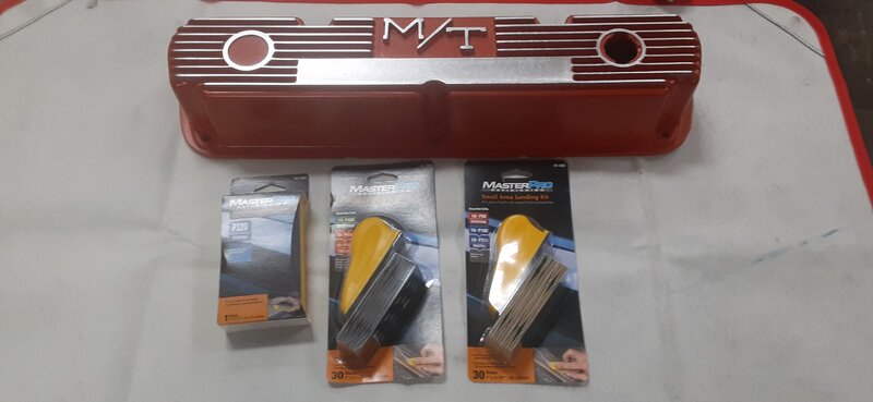

Like the title says I know little to nothing about painting, most of my experience comes out of a rattle can. You can see in the pic what I'm going for. I just want a bright aluminum look not polished. I have decal the print shop made for the large flat area then a few coats of clear.

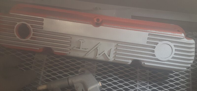

I painted painted the V-covers with a coat of self etching primer then 4 coats of Dupli-Color engine enamel with ceramic. This was a couple 3 weeks ago. Came to the shop today to get in some personal work while the sun was shinning and get home before 11++ pm. I thought all was going well till it wasn't. Started the sanding with 120 then 220 then final with 320. Notice on the first one the paint chipping/flaking off at the edges. Thought maybe the 320 was to aggressive to start so, I started the second one with 220 then the 320. Same thing.
What do I need to do to remedy this. Should I put them in the blast cabinet and start over with a different paint. Or, can I just use the same paint and do the sanding while it's a little soft not a 3-4 week cure time. Thanks for any advice.

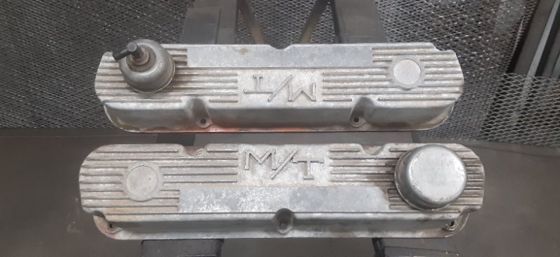

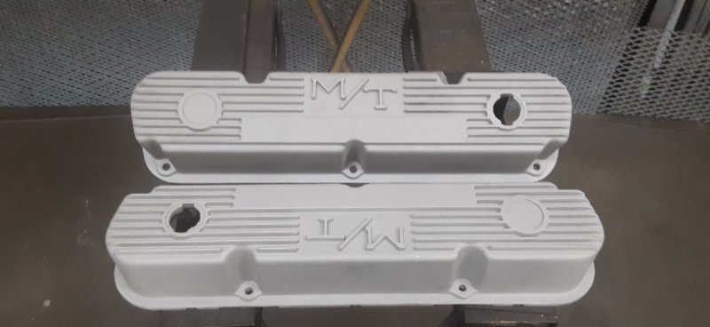

I did blast them first. Got them used for like 75 or something, not real pricey, wasn't over a 100.

Prep work was - Blasted then wiped down with acetone. Etching primer applied, 1 coat. Allowed to dry then the color was sprayed in lite coats and maybe 30 min between coats. Last coat was wet to the (my) eye.
I don't recall if the primer was Duplicolor. I have to swing by the parts store and see. That could have been part of it. I've run into issues with combining different brands of rattle can paint before.

It's the DA. It is pulling the paint off the corners as it rotates.
Hand sand, only, in the direction of the fins.
Totally agree with hand sanding. I did not see where he said he used a DA. Maybe I looked over it. But you are RIGHT! DA is NOT the way to go on a project like this.

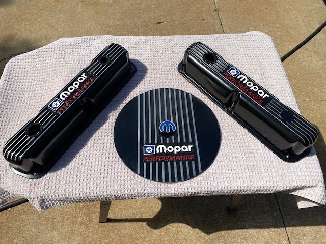

I have been powder coating for about 20 years now, and I have done a lot of valve covers, but in the past, I have done them with paint.
Here is how I would do it: Blast them down to bare aluminum. I use medium grit crushed glass. I have found that it leaves a perfect surface for paint or powder coating; not too rough and not too smooth. Then I would use the Rustoleum Automobile rattle can primer that @RustyRatRod mentioned. It is lacquer based, it fills blemished very well and it is easy to sand. I get it at Wal Mart for about $7 a can. It is pretty much the same as the lacquer base Duplicolor primer sold at car parts stores but a lot cheaper. I'd spray a light coat followed by two medium wet coats. I always wait at least 10 minutes between coats to give the solvents time to evaporate. Then I wait a few days to make absolutely sure all of the solvents have evaporated. Then I would wet sand the entire valve cover with 320, 400 and 600. Then, using 320 wet and a sanding block, I would sand all the primer off of the top of the fins, letters and that big rectangle in a straight linear fashion from end to end. Do not sand these places in a circle or side to side. If you do want paint on that rectangle, then sand it with 320, 400 and 600 like the rest of the valve cover. I would use a scotch brite pad to get in tight places like in between fins. You can use wet sandpaper that has been folded over several times to make it about 1/16 - 1/8" thick. Then paint them. Always make the first coat a light coat. Do NOT go for full coverage with the first coat. That is an invitation for runs. Then you can go with medium wet coats. Then I would let the paint dry for at least two days before sanding the tops of the fins etc. I would do that with 320 grit wet sandpaper on a sanding block going in straight lines end to end like mentioned before. By waiting several days and wet sanding in straight, end to end lines, I can pretty much guarantee you it will work out fine.
BTW, here is a pair of VCs I did for my Barracuda with powder.

A lot of good advice and ideas, thanks. I'm going with a complete do-over. Like my ol' man said "The road to success is paved with failure". I do no not think there was an adhesion issue, as I'm having to be verry meticulous as I blast them to get complete removal.
I believe my downfall was using a DA to sand the tops. I am going with the wet hand sanding on this attempt. I'm pretty sure that will give me the results I'm looking for. I like the idea of from @harrisonm of sanding primer from the raised areas before moving on to the color.
