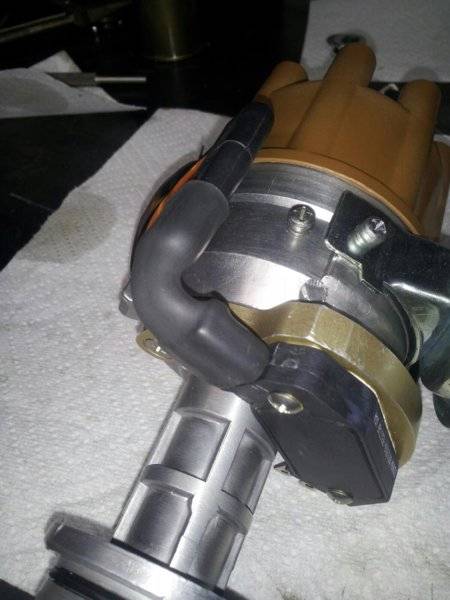

"Appear" like a stock 273. Stock valve covers and everything painted heads and all 1967 commando red. Intake is my performer RPM with the markings ground off and Eddy 750. My electronic dist with hidden HEI 4 pin. Those in the know will spot everything, but the casual observer, honduh, chivvy, or furd guy probably wont. Would prefer to use my 68 340 hi performance exhaust manifolds to complete the look, but i know they will leave some horsepower on the table. This is why the headers and them being painted cast iron gray.
