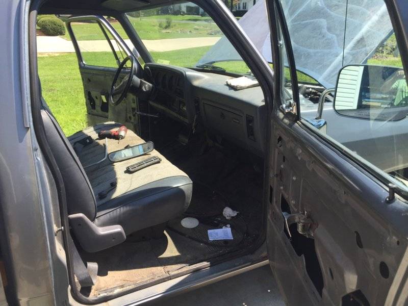

    235108B4-19E4-4BB5-95A8-64BF2326706D.jpeg F2E9E478-AE47-4142-9EF5-C5EB56939C0F.jpeg 0B872E46-5925-4222-AEA4-62651B76B769.jpeg F067A94C-32D0-4C48-8D9F-7AB941E358BE.jpeg Guys, I figured I would tell my story on a 91 Dodge Ram D150 that I bought for $300.00 in the summer of 2016. Prior owner told me it needed at transmisson, but I drove it home in 2nd gear. Began pulling the interior for cleaning and also did some maintenance on the engine.

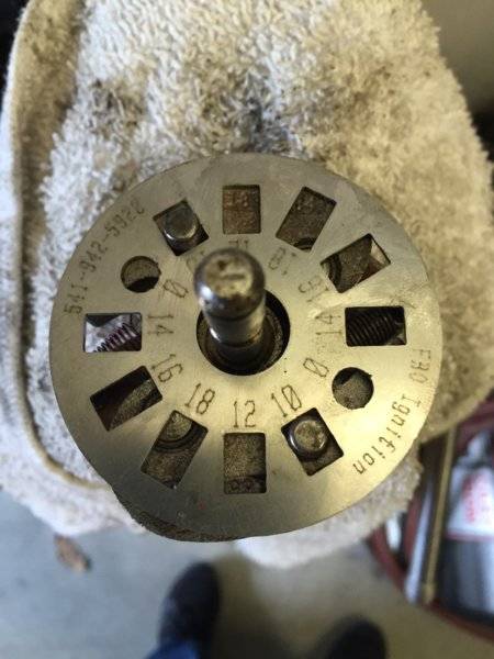

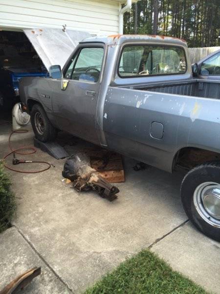

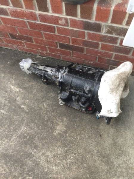

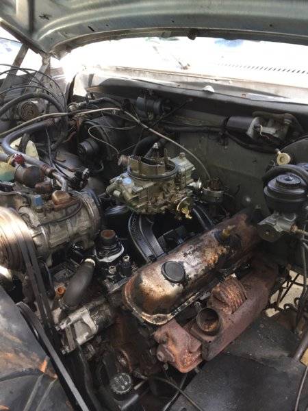

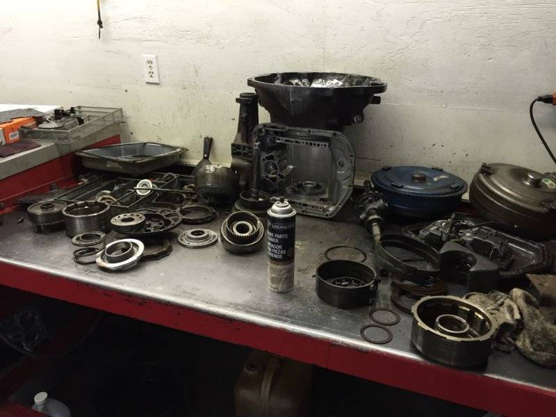

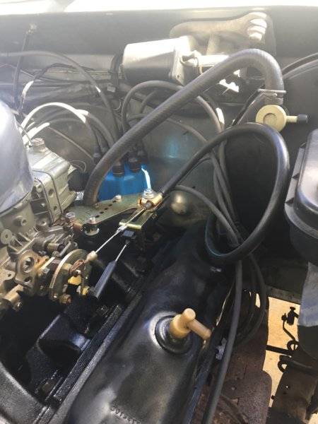

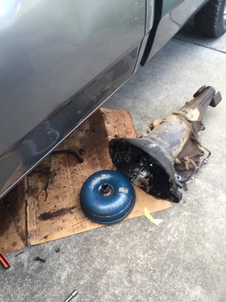

      Decided to pull the trans and have my friend blow it apart to see what it needed. Most everything was replaced

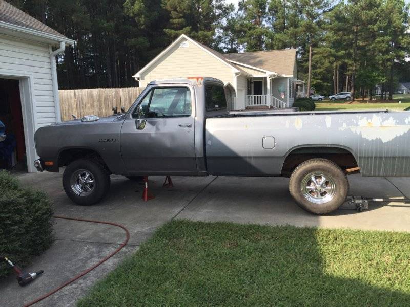

      Reinstalled the trans and drove around for a couple of months. Absolutely loved it. It was burnout machine also!!! 318 TBI was shown no mercy and we routinely tested my friend trans building skills I acquired a set of 15”cragers and soon realized that the Crager hub was too small for the big Dodge hub on the front. Had my rotors and hub cut down on a brake lathe. Didn’t take much and I was able to run the cragers. Also my cousin welded me up a dunomax muffler for some sound, also did a cat delete.

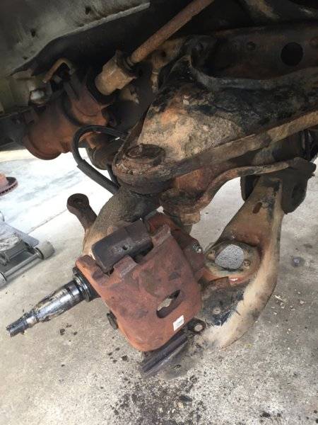

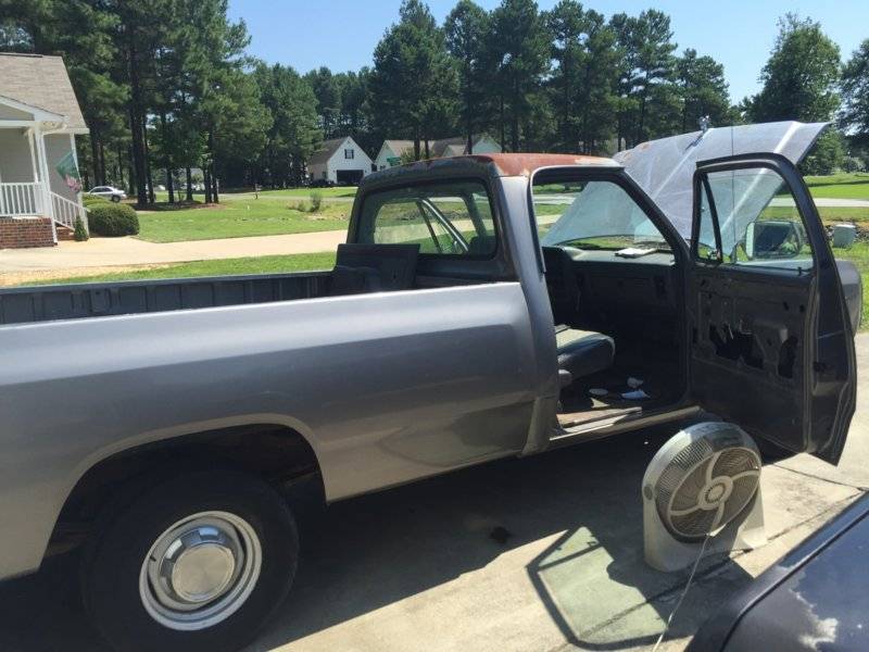

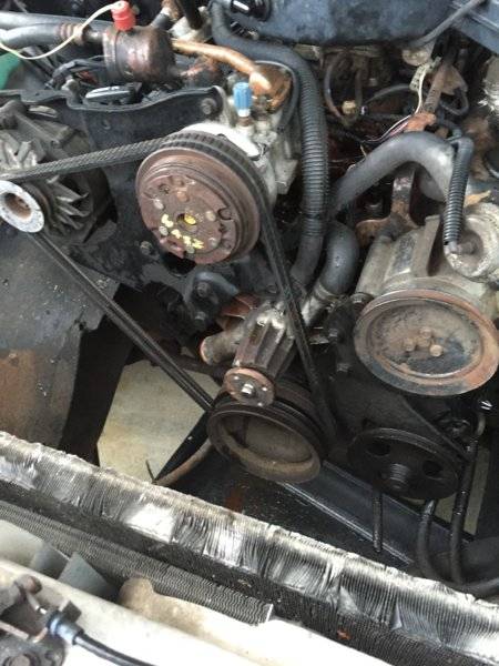

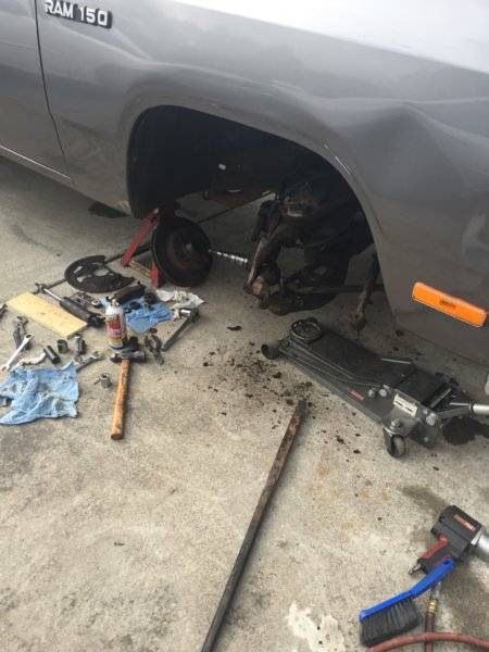

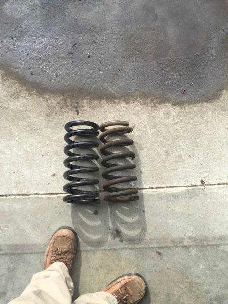

        Rebuilt the front suspension. New coil springs, shocks, etc

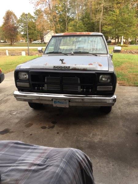

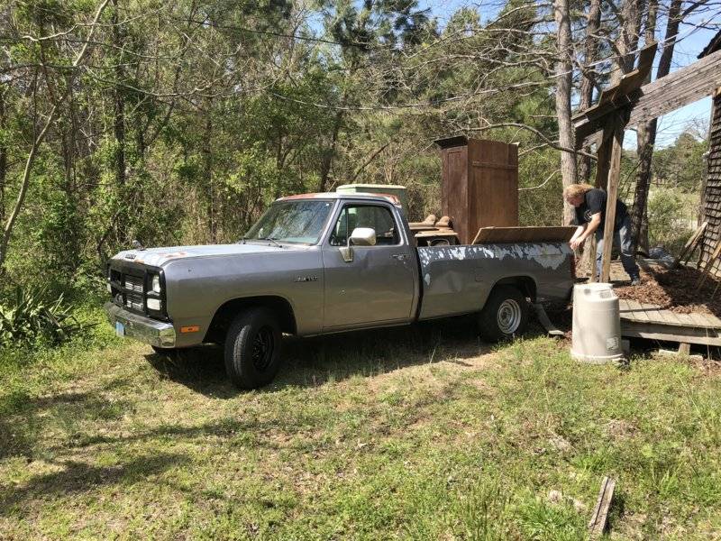

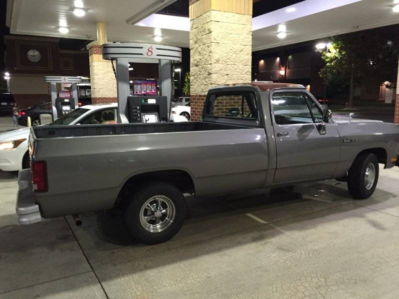

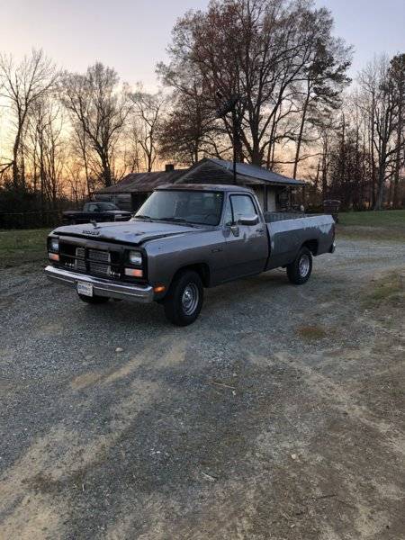

        This was the final look

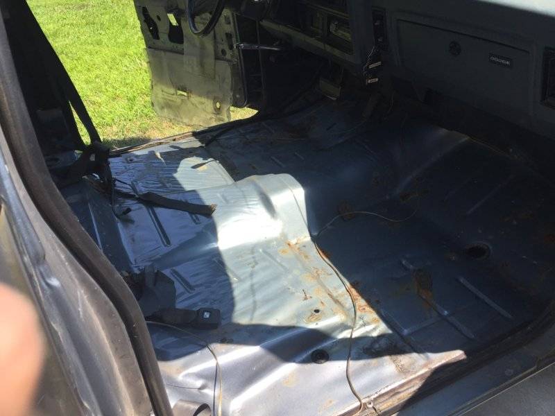

          Fast forward to summer of 2017. My son gets deployed and I break up with the girlfriend. Needed to occupy my time I decide to Turbo the truck.

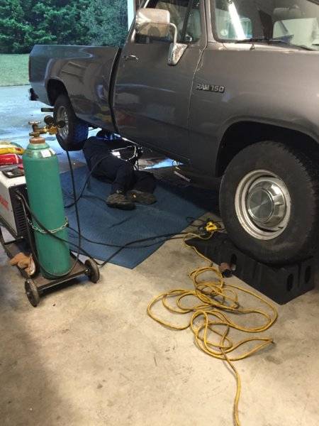

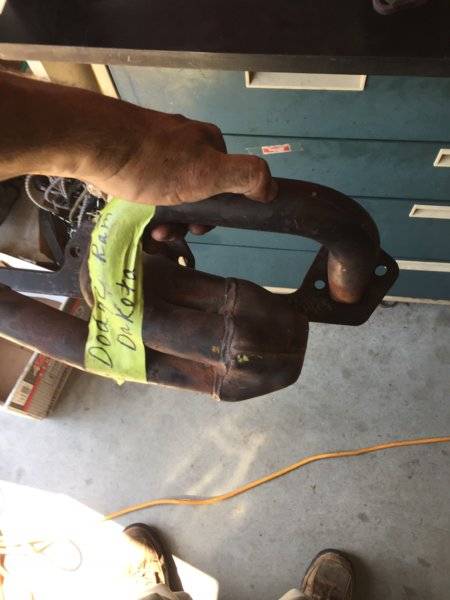

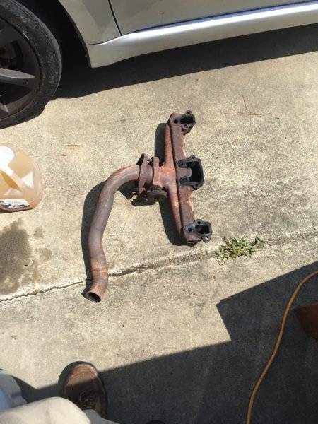

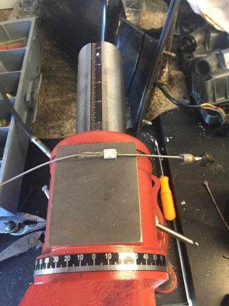

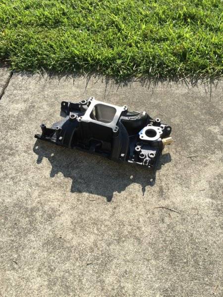

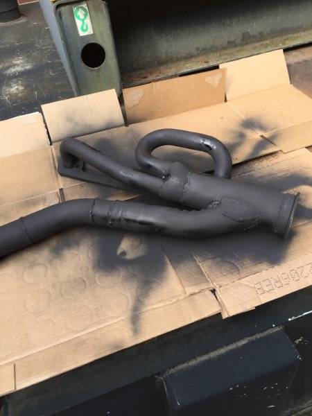

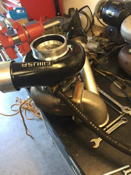

            Ordered most of my parts and finished my manifold fabrication.

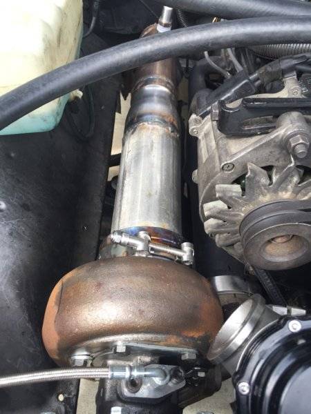

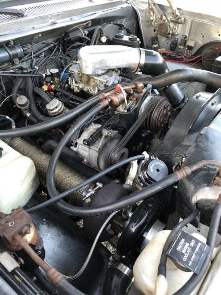

              Turbo and wastegate mounted

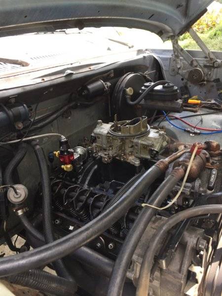

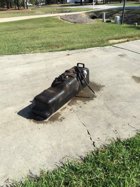

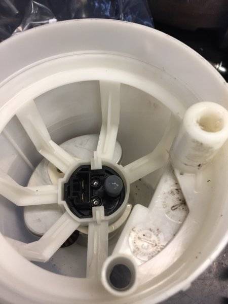

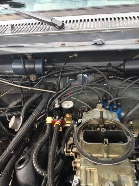

                Time to address the fuel system. Now most would be like why did you take a great running TBI Truck and change it over to carb. Well the TBI has its faults and I knew it wasn’t up to the task of handling some extra fuel. Changed intake, built a 650dp blowtrhu carb. Mounted FPR and in tank 340lph pump. Ran new supply and return

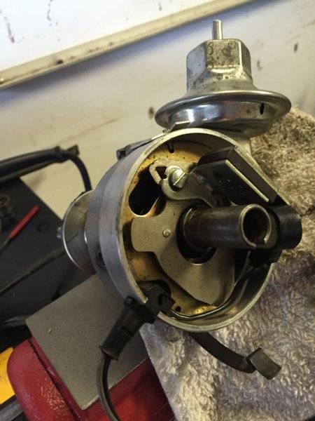

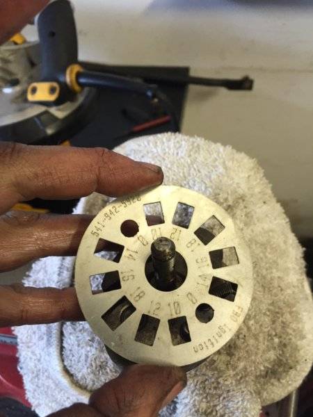

                  Changed distributor to electronic. Depimned the factory wiring harness so gauges worked, had to run an external voltage regulator. Changed/made a throttle cable

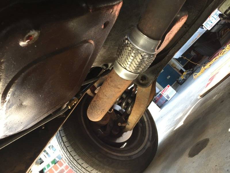

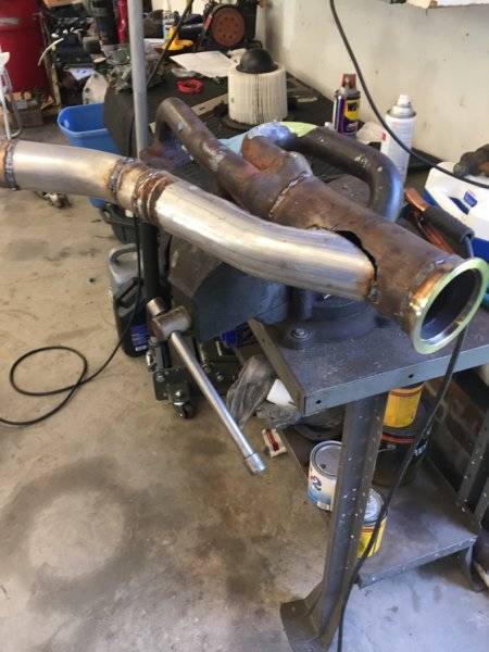

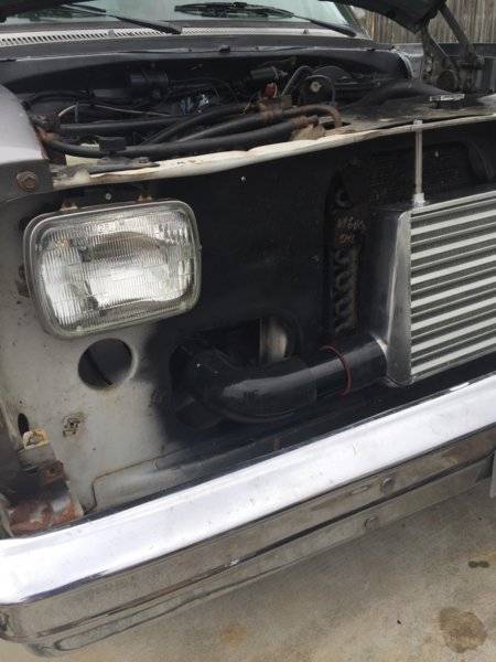

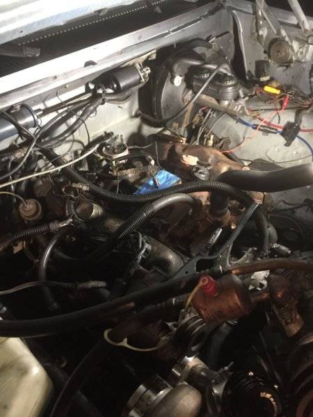

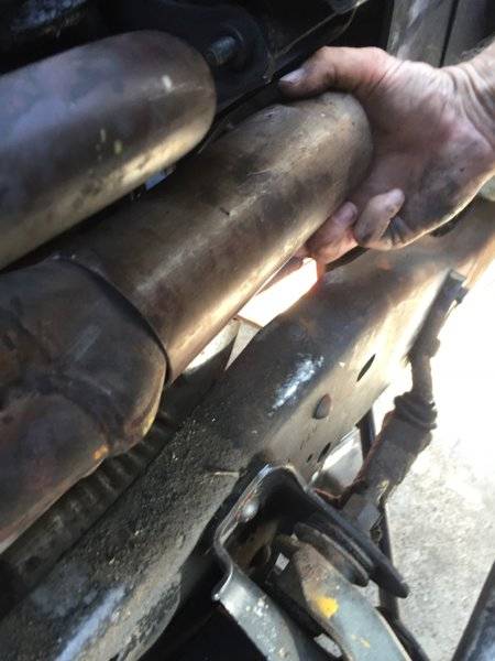

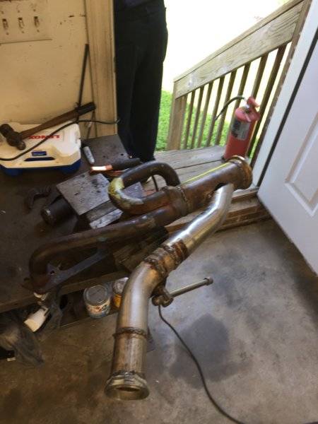

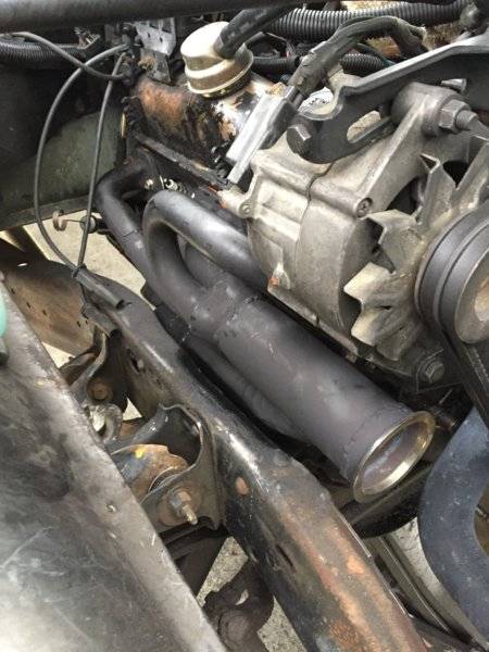

                    Mounted intercooler and piping, made a downpipe

                    Pics

                                The parts list is a combination of eBay, Amazon, summit, Jegs, VS racing, quantum fuel, Craigslist, junkyard and my cousin. You have to do some homework to find the best prices. The prices listed is what I paid at the time of purchase
                                91 Dodge Ram turbo set
                                Mandrel tubing $free, $6✅
                                Used set of Dakota headers free.✅

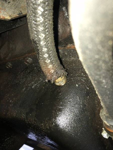

                                  Turbo oil feed is teed into the oil pressure sending unit. For the oil return I punched a hole inthe oil pan, tapped it and bought a pushlock fitting. I will post a pic later.

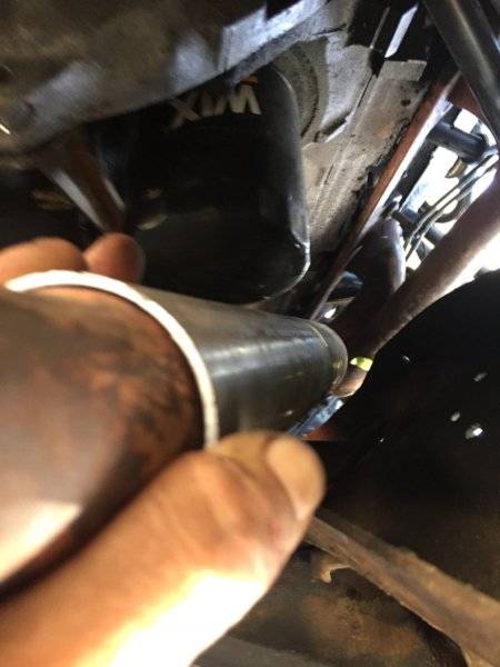

                                    Here is a pic of the drain line into the the side of the pan. Note the oily mess the engine was and still is . Looks like I have some seepage around the fitting.
