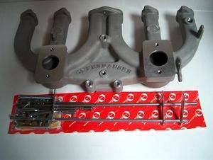

I am getting ready to install the above on my 225 with the stock /6 rotating gas pedal assy. Has anyone done this? What mods need to be done to the rotating assy? Anyone have any pictures? I don't want to convert to a cable so please don't suggest. TIA Tim
Offenhauser used to offer a linkage kit for the rotating rod early slant six throttle linkage. May still, don't know. Here's what it looks like. You might could fab something similar.
